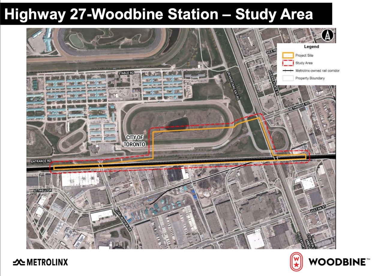

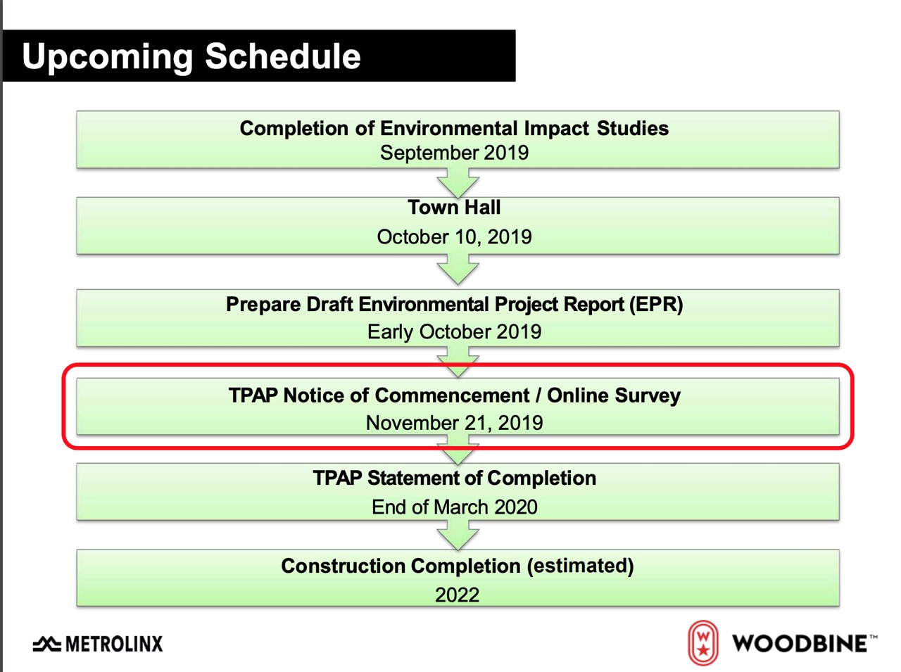

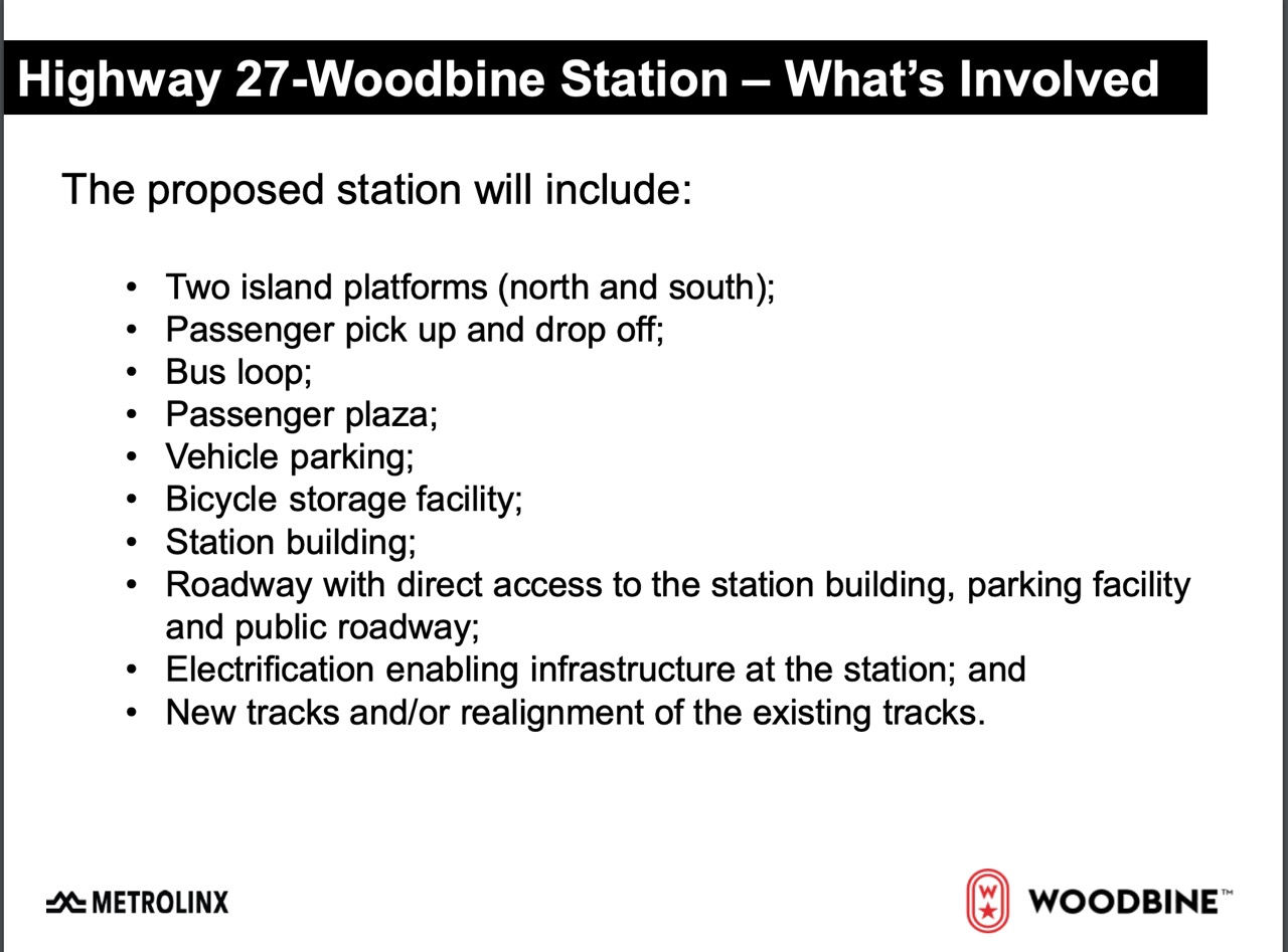

Sorry if this was posted before, but evidently the Woodbine GO Station TPAP started in November. I wasn't aware. Evidently it is slated to open in 2022.
Presentation here, and project site here.
Some slides of interest:

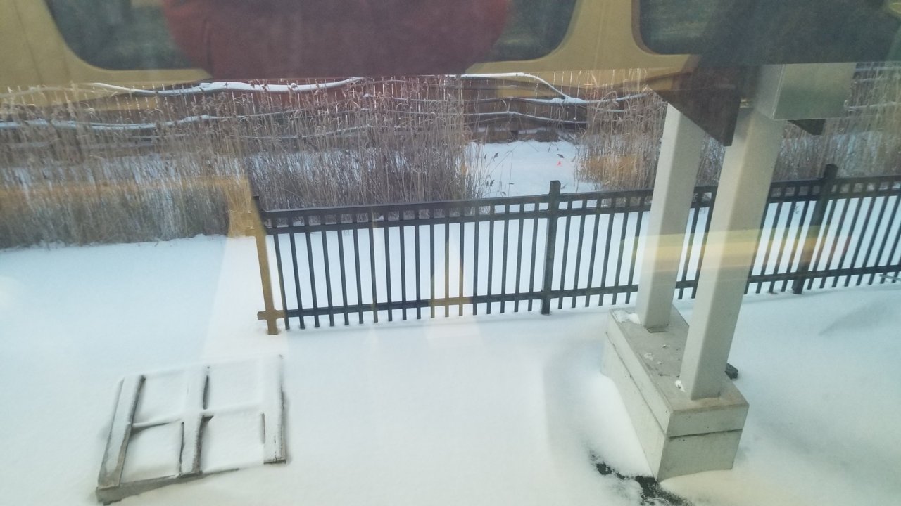

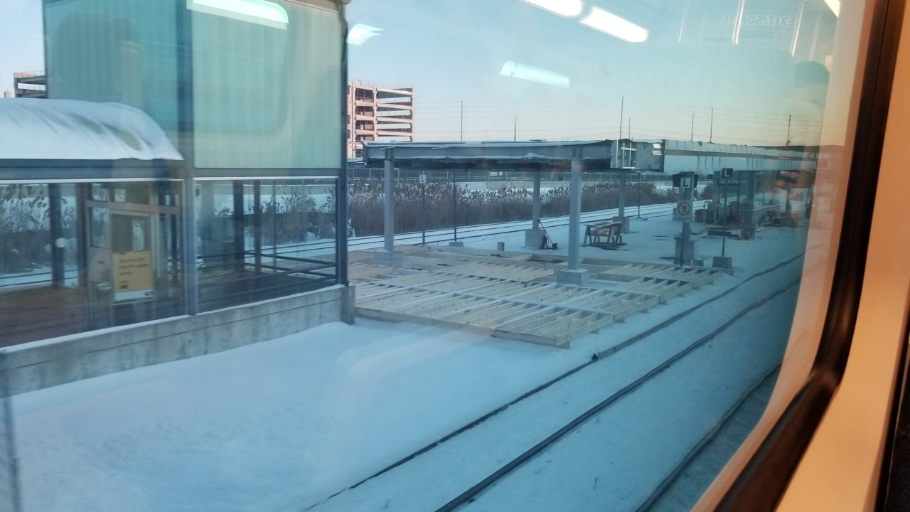

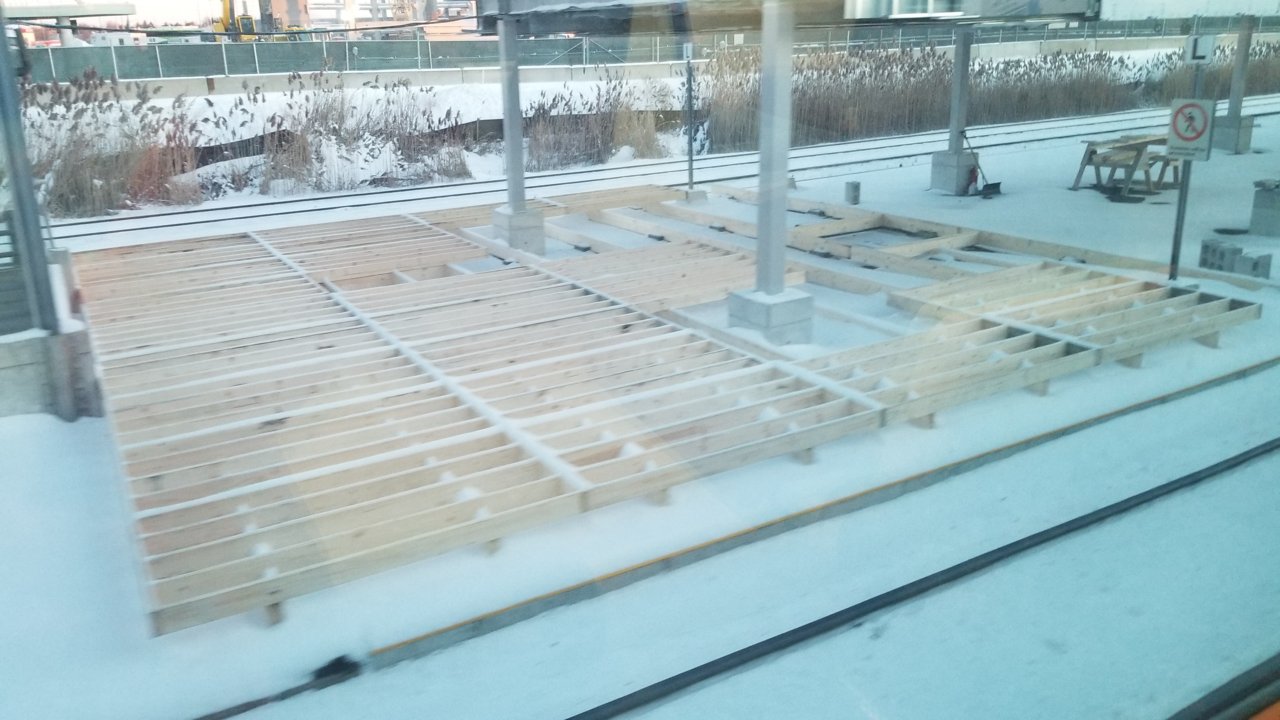

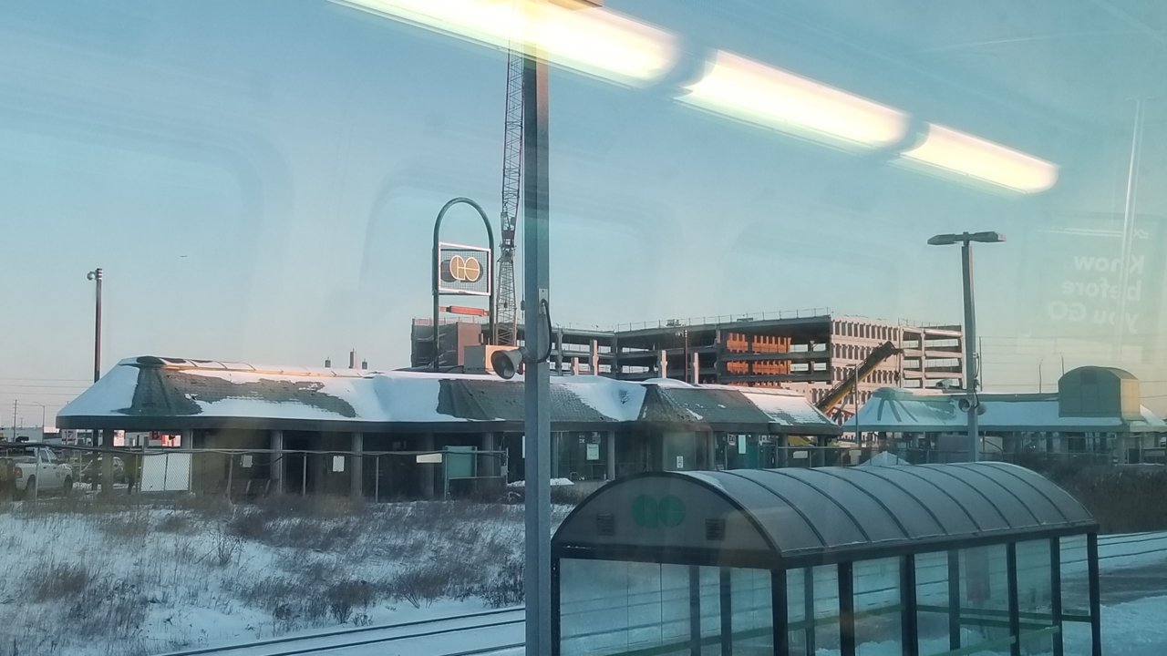

Bramalea Go this morning. Looks like they are putting up fencing on platform 4 as well as seating (not pictured) and a new accessible ramp.
On platform 2/3 it looks like a new accessible ramp will be placed east of the existing one and elevators. Not sure when all of this will be finished but fingers crossed for april???

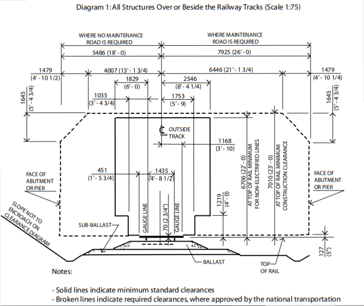

^ Sorry I misunderstood what you wrote. I thought where you said "Not talking just about the accessible ramp, but the entire platform height where the gap is not an issue" you were suggesting they make all platforms the same height of as the accessible ramps. My understanding is that it's not the platform height issue for freight trains rather it's the width clearance they need. That's why there's the ramp to close the gap.
From: https://www.tc.gc.ca/eng/railsafety/standards-tce05-233.htm
