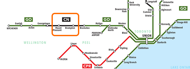

Battery trains for the short freight section -- catenary from Kitchener-Georgetown, and Bramalea-Union. Battery mode to hop the CN section.

^ Yes but doesn't Metrolinx own the tracks west of Georgetown? On mobile so I can't check the RAC map to refresh my memory.
They do. Look at my diagram.

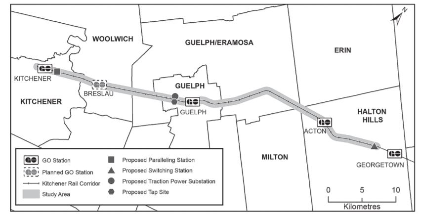

Not to dispute the possibility of dual-mode, but Metrolinx's map shows a paralleling station, traction power substation, tap site, and switching station for the Guelph Sub. The presence of a switching station, IMO, makes me think they are highly considering piecemeal electrification from Kitchener to Georgetown, or at least are treating Guelph Sub electrification as a separate project for engineering reasons.
