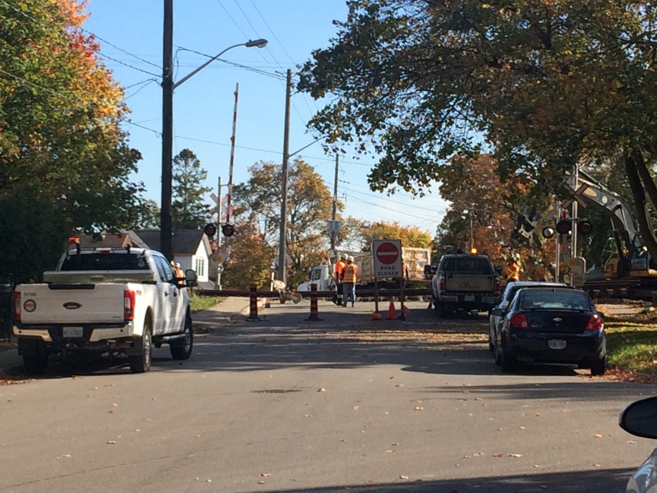

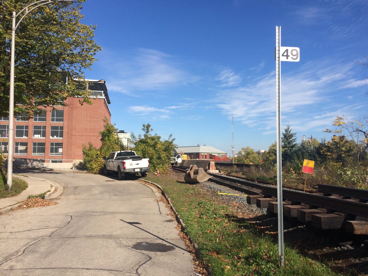

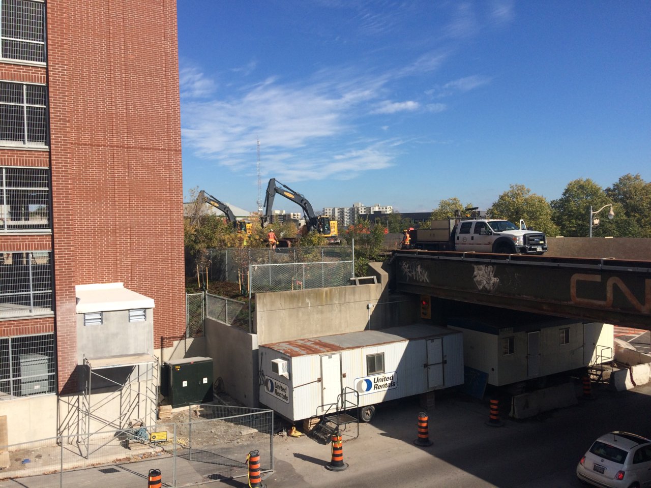

Lots of work happening on the Kitchener Line in Guelph this weekend. Pictures taken along the "street running" part of Kent Street and the Yorkshire crossing.

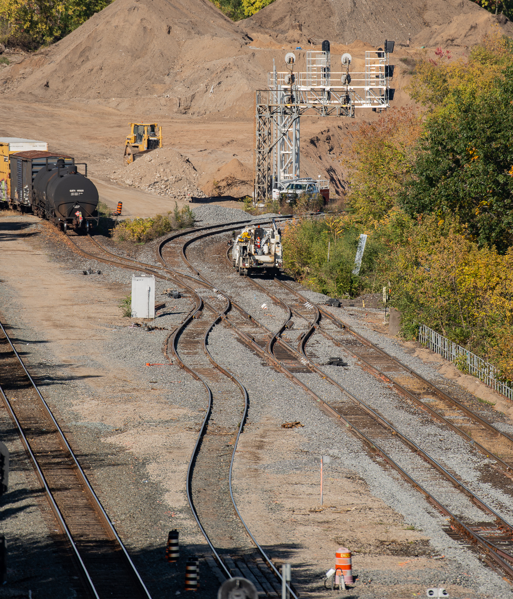

I was handed a little crow to eat with my Thanksgiving turkey this year - after venting about how the Hamilton Jct interlocking is a long ways from getting reworked to enable increased Hamilton service, CN actually started making changes last weekend and (I'm told) will continue with the work over the fall. So far, a couple of switches have been moved further north, which creates just enough room to squeeze in some new turnouts to re-attach one of the two connecting tracks to the CP line to Hunter Street. If you refer back to message 5668 in this thread, you can sort of see the difference.
If work stays on track to the New Year (always a big "if" with this sort of construction), the new track from West Harbour to Bayview will be complete, and the chokepoint between CN freight and GO movements will have been mitigated, which brings 2WAD service all that much closer. It's a complicated task..... good to see ML finally found the money and the sense of urgency for this work, after several years' worth of kicking stones.

Silly question, I'm sure, but I apparently need to learn something............what's with that bizarre-looking (to me) alignment for that connecting track with the 2 distinct curves on its way over?
I have two theories on that. One is that it’s the simplest and cheapest way to have connected the existing alignment to the relocated turnout, particularly if it’s just temporary until the next bit of trackwork is added.
The other theory is that the next step will be to install a turnout in that midsection, so the odd curve is a diverging route but there will be a straight route added. Note the red surveyor’s stake (or conduit marker?)....that may be the midline of a further track addition. When I imagine the eventual design, that seems a very likely prospect.
Of course, someone may have simply decided to add a “wheeeee” factor to the ride, but you are correct, it’s not really the way one would want a train to wobble its way thru the junction ;-)

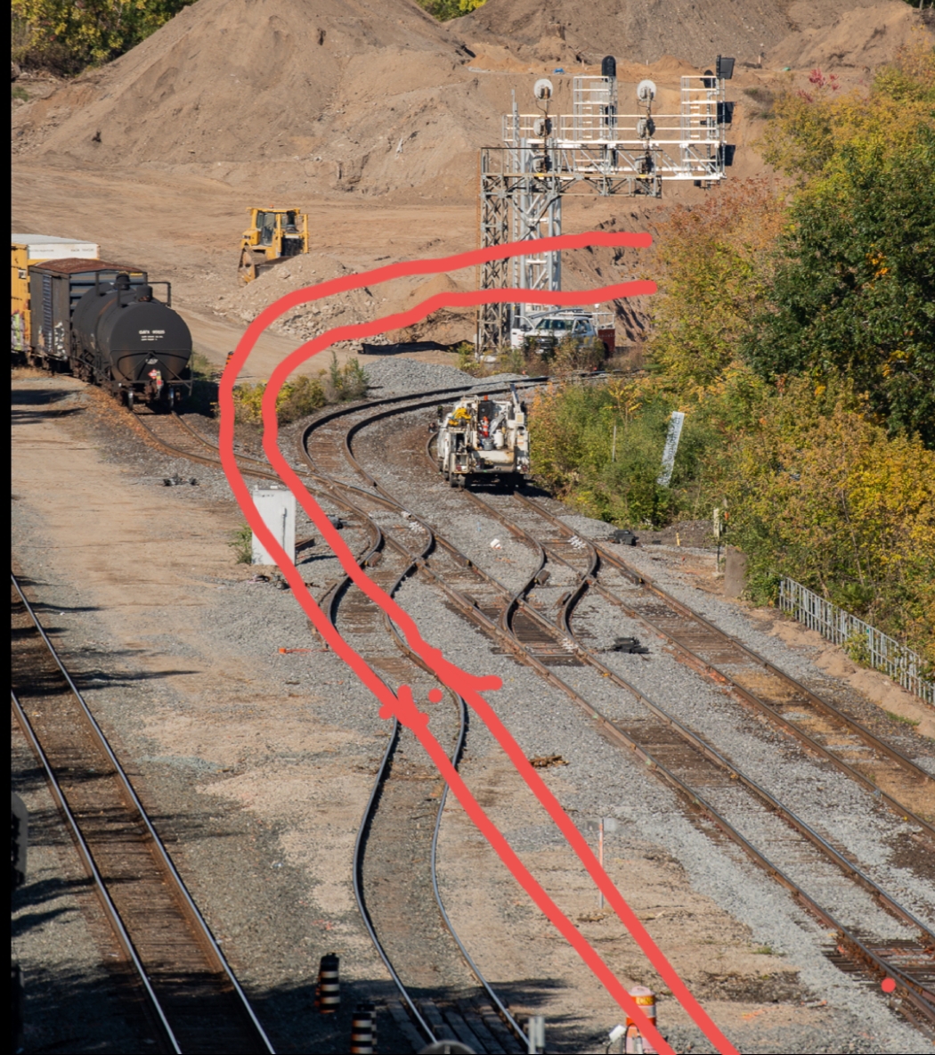

So just to visualize what's going to happen, is this how the third will be extended through this area?
210468
^That would be my guess, yes. And add a set of xovers from your new red track to give a route towards the xovers just below the line truck.
The red line you drew ties to the south connecting track to CP plus the new track to West Harbour. The added xovers would give a route to T3, keeping trains out of the way of Brantford bound trains at Bayview.
