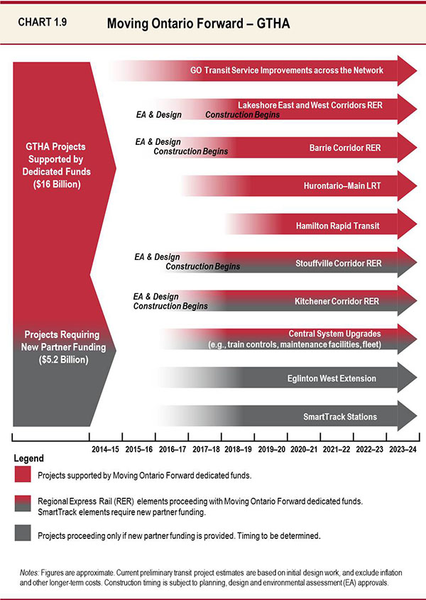

Metrolinx budget shrink?
Metrolinx capital plans over the last few years had about $2B/year for GTA transit spending solely from provincial funding. I'm hoping the April budget clarifies that this is in addition to other capital spending and that, for example, Ottawa's long promised phase 2, Hurontario LRT, or Hamilton LRT funding won't be coming from this bucket.
^seems a bit of a cheap shot by the federal minister. this week marks a year....and the "Ford" government is only now getting going on it....should that not actually say "Ontario" government? Despite his many flaws, it seems hard to blame Ford for the first half of that "lost" year.
Interesting observation. How does it compare to the last budget under the Liberals?
The Ontario Public Accounts document says that Ontario spent $7.4B on Transportation and Transit in 2017-2018 (pg 27) and $6.0B in 2016-2017
What Wynne promised to spend if reelected is probably irrelevant as her financial strategy was unrealistic as heck.
I have no idea if the Tories will account in a similar manner so this may be apples to oranges, but these are the published numbers.
^ Thanks. I seem to also remember a bar chart in a Metrolinx report that showed the GO RER spend between 2014-2015 and 2025-2026. I can't recall now where that was.
Update: found what I was thinking of: https://urbantoronto.ca/forum/threa...-projects-metrolinx-various.9023/post-1320445
Also, this is what the Budget 2016 included.
