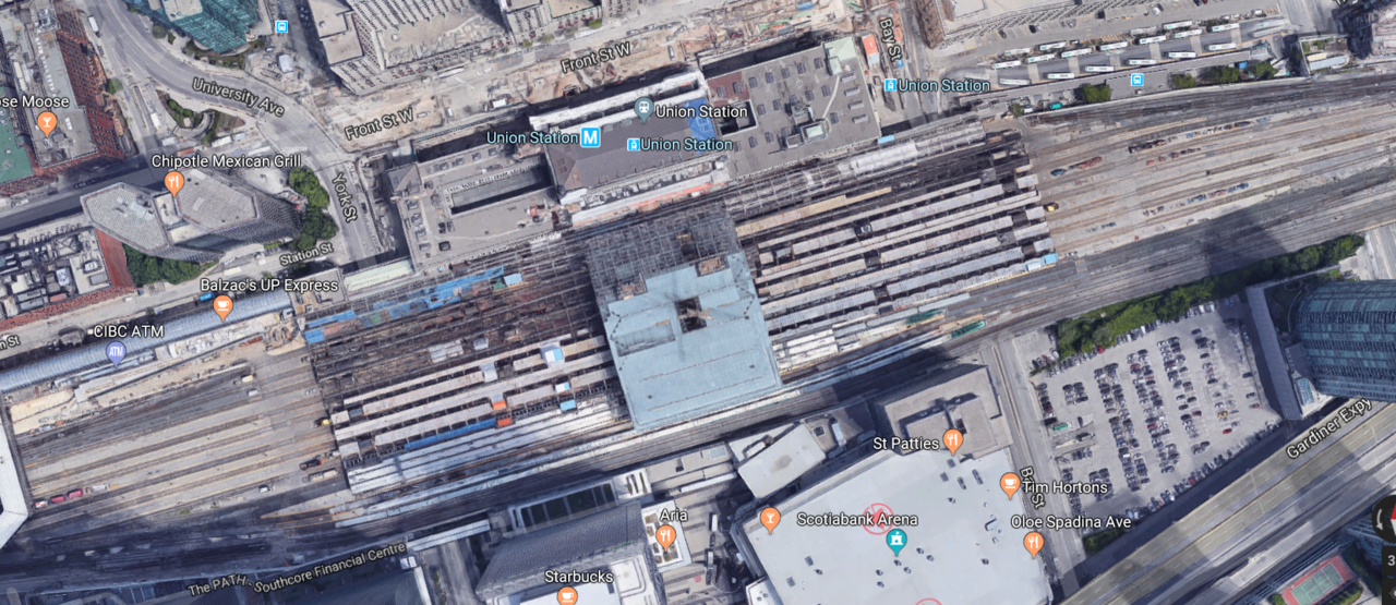

Here's an overhead Google image from link. We can barely make-out the current platforms and tracks. The number of tracks will be reduced by 6, the number of platforms will be reduced by 3 but wider.
The province intends to award a contract for the entire $16.8-billion GO expansion program, including the Union platform reconfiguration, by spring 2020.
