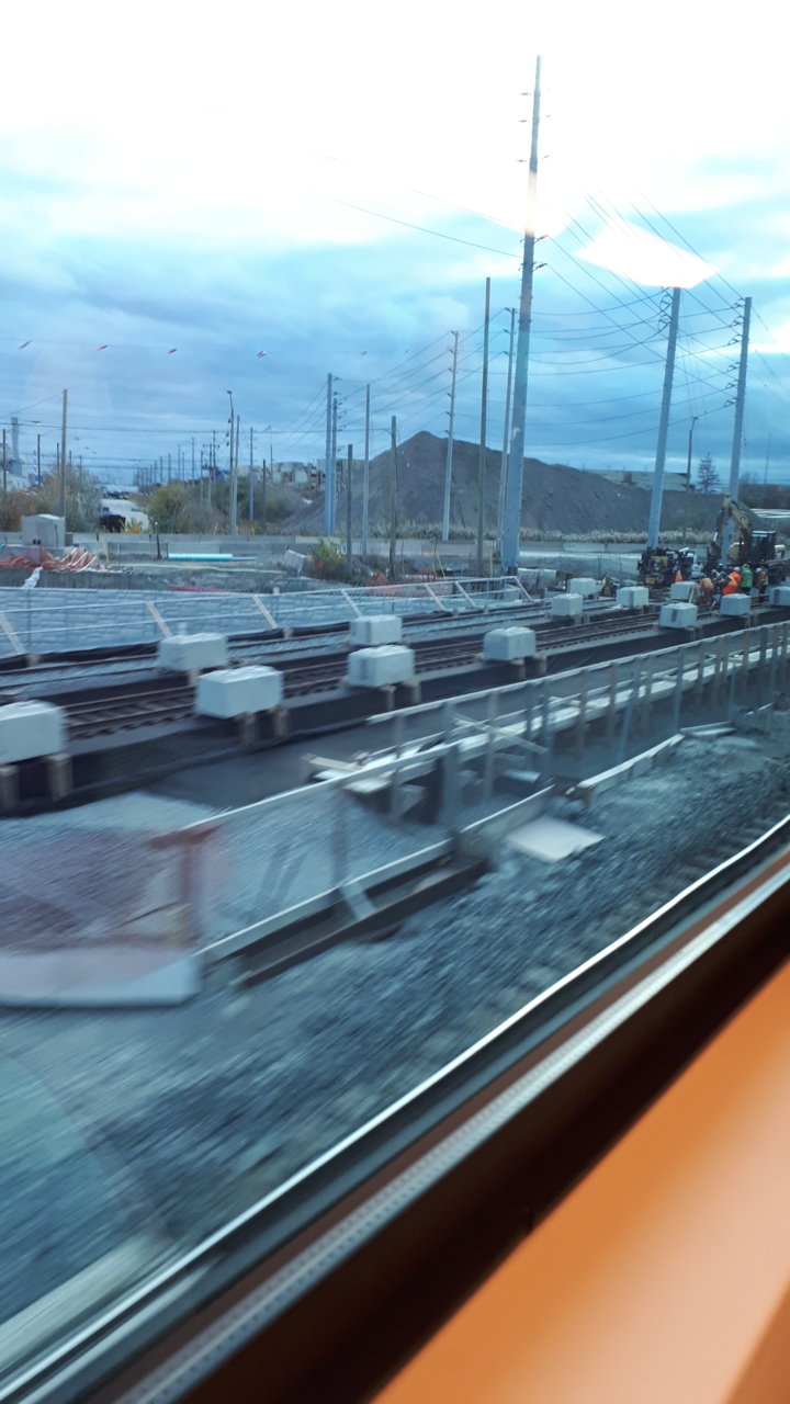

Blurry window pic of Torbram

I hope they accounted for these sound barriers being so close together! If not done right the sound can actually reflect off each side and amplify the noise.
Good catch. You have an intuitive sense of acoustics and waveguides. There is a way to mitigate the 'channelling' of the sound, and they're not doing it, oddly. I've seen the technique used under bridges on the GO system, and I'll look for a well-explained and detailed article to link later, but basically the technique is to present an 'anechoic' surface on the wall such that it scatters longer wavelengths in a way that the disparate directions from scattering/diffusing tend to phase cancel if the proportions of the 'diffusers' are matched to the wavelength(s) to be subdued.
I can see very real problems if they copy the opposing wall with the same surface in the pic.
More later, sharp eye! The term for the concern is 'Standing Waves'.
Must run, but quick Google shows these results. Not mentioned that I see in the cursory perusal is 'slotting' which I'll discuss later.
https://www.google.ca/search?q=Para...19j0j7&client=ubuntu&sourceid=chrome&ie=UTF-8
I'm amazed the neighbourhood reps haven't raised this issue. That being said, as long as one opposing surface is 'treated', the other can remain as shown in the pic. The clincher will be what they raise the other side. The posts don't look promising for something anti-acoustically active.
Oh that would be hilarious because it's precisely the kind of thing I can see Metrolinx's incompetent contractors fucking up.
Agreed, save that it wouldn't be in the contractual execution stage, it's in the *design* stage the shortcoming exists. As soon as I glanced at that pic, I immediately saw the propensity for serious trouble. It's an *invitation* to acoustical resonant properties run amok.
Consider that all it takes is rubbing a quality resonance device, like a massive church bell, to excite it into resonance. Or quality wine glasses. Just rub the lip (no further comment on that...wine is fine)...energy is *waiting* to be excited if not already in that state. And running a piston (train) down a channel with such rigid walls will do exactly that. Think a tunnel minus one of the containment surfaces.
This is such an incredibly bad faux pas. Standard practice would be to pleat the walls in a zig-zag pattern, offset to each other by the ratio of the 3:4:5 Pythagorean relationship in as many planes as possible.
Oh Lordy, Lord...
Oh Lordy, Lord...
While it is an issue, it can be mitigated by adding some acoustical sound absorbing/dispersing material to the existing wall.
However, the walls themselves should have been selected with this type of property in the first place. But its not like it is not something that can be added at a later date, if they turn out to be a problem. At additional cost of course.
Im sure Metrolinx avoided any zigzag pattern of the walls because they want to use 100% of this available corridor space... it looks like there is just barely enough room to fit in 3 tracks, for express service.
I have to disagree on the amount of extra space needed. The efficacy of this compared to the 'Origami' system will be limited, but still a huge improvement over what apparently is being done in this instance. I've yet to delve on the "notching" (notch filters) I mentioned prior, it's a topic in itself, as it involves 'voicing' of wanted or unwanted sounds.
