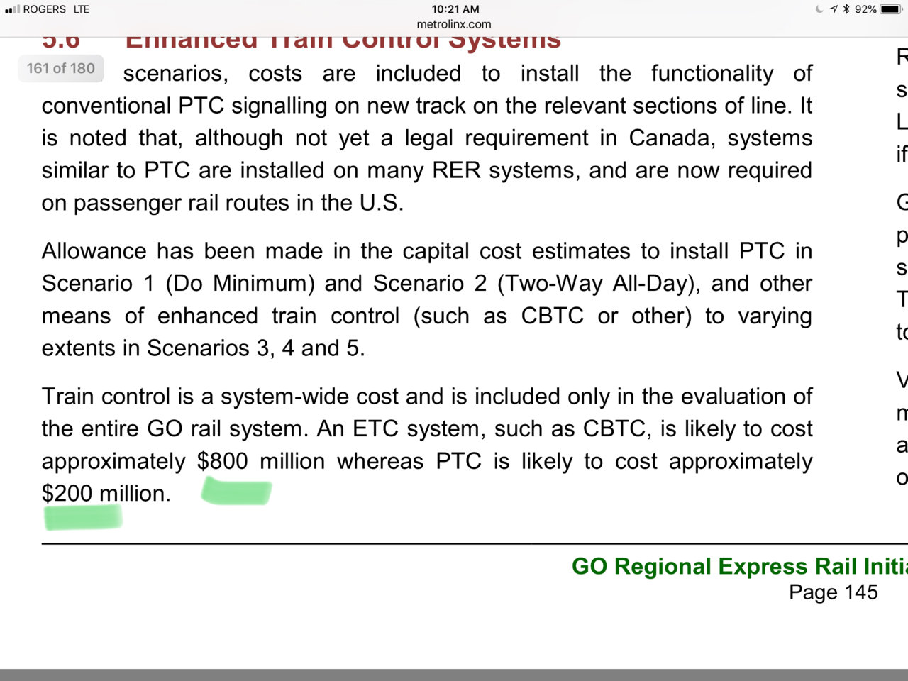

It's a legitimate question.
Supposedly, $200 to $800M of the $13.5 billion RER is the new system that supports these trains.
http://www.metrolinx.com/en/regiona.../GO_RER_Initial_Business_Case_EN.pdf#page=161
Price quotes of PTC/CBTC come from section 5.6, Page 145 labelled, Page 161 PDF viewer.
It is possible not to spend this cost, but would probably put constrains on trainset selection.
