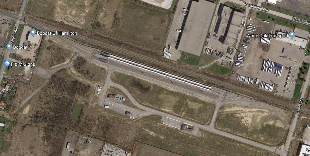

Regarding Lewis Yard:
It already has 4 tracks. I wonder if that's to upgrade it to 8 tracks?
The Google Satellite map shows the Lewis Yard is the current layover for the two morning West Harbour GO trains. (this is presumably a weekend satellite photograph)
There seems to be lots of room for many more tracks (long term expansion shows 8 sidings), but the expansion could also be the eastwards continuing tracks -- grading work was already done for that, but is not connected on the east side.
Hopefully the CN negotiations will include some good service ramp-up plans for this corridor to more properly and fully utilize West Harbour GO and/or potential inclusion in Niagara GO service.

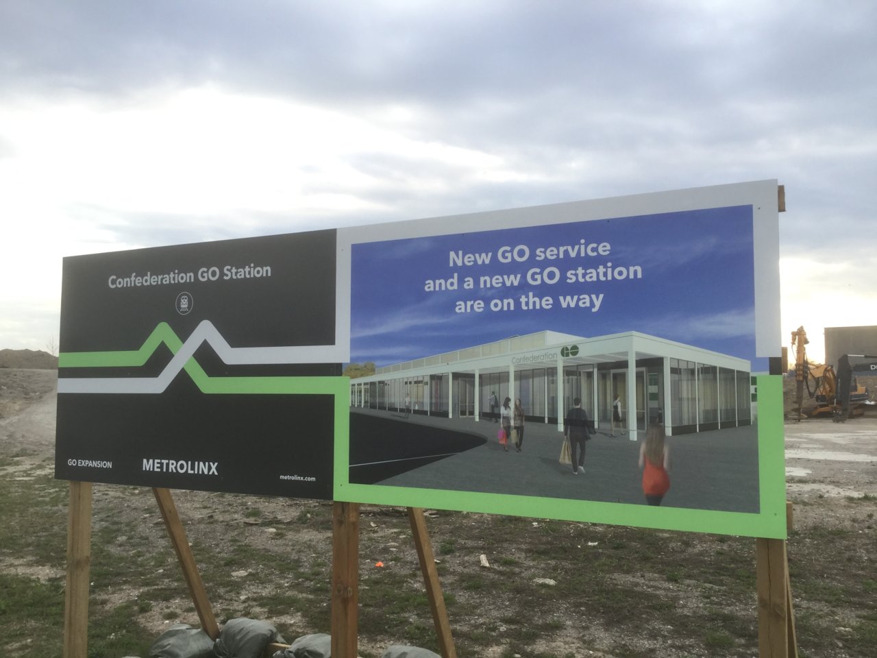

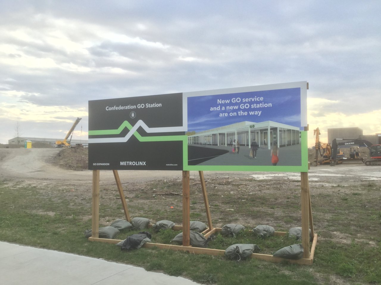

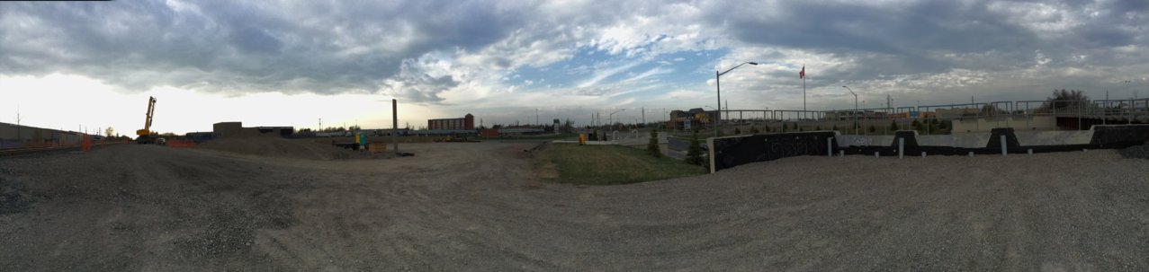

Confederation GO station construction site.
