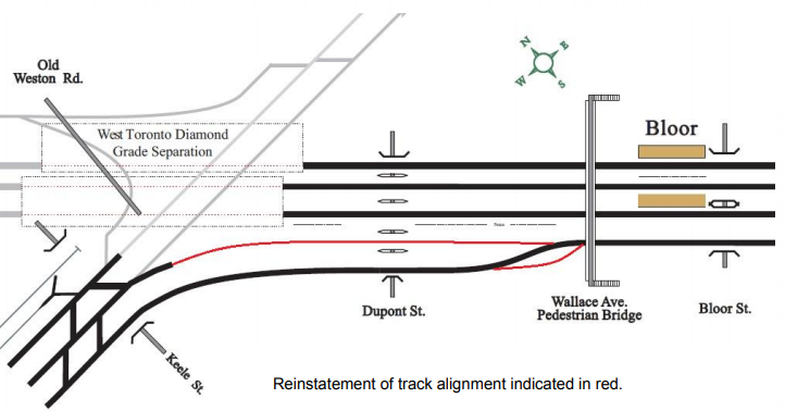

For Milton, some track work for the 2nd track being put back in (picture below). Also, from the last Board meeting, I wonder when this report will become public: "The Milton Corridor Capacity Study was completed and the final draft of the report is underway, following an extension to include scenario and potential impact of express trains"

^ I assume all the way to the Union Station Rail Corridor West and then be integrated with the Lakeshore tracks that meet the Kitchener/Barrie Line tracks here at Fort York. I think that's how it worked before it was removed during the Georgetown South Project.
^ I haven't seen any drawings, but from the tender descriptions I'm dubious that it's going any further south than right there at Wallace. That switch will allow trains to take either of two routes through the West Toronto interlocking to Keele Street. But for now the Milton route will remain single track down to Strachan.
Note the two as yet unused block signals on the overhead bridge. They don't match the new work. The crossover here is likely "temporary".
Why bother? It gives much more flexibility in routing west of here over to Kipling. CP may have required that in return for added service. And - it also provides a meeting place for GO trains should CP allow some form of equipment turnback or counterpeak service. I'm hoping (with no documentation to support it) that this may open up some opportunity for further service improvements.
PS: the "old" two-track arrangement had 30mph turnout/ curves at Dupont/West Toronto. The second routing being reinstalled will be 45 mph. So it's an upgrade to the "old" stuff.
Double tracking for the Milton line was envisioned to extend through the Strachan trench, and then before the USRC interlocking with Lakeshore West, both tracks would merge into the southernmost track for Kitchener/UPX. But that was back a few years ago now, don't know if that has changed.
That's the ultimate design, and it still stands. But there seems to be some earthworks further south of Wallace that would need to be done before the track could be extended.
As Paul noted, this is likely just an interim option.

See Notice:
Work began in November to reinstate the second span of track on the Milton corridor between Keele Street and Bloor Station. During construction of the West Toronto Diamond grade separation, this span of track was temporarily decommissioned, as trains could not safely operate so close to the work site. With construction in this area completed, the second track can now be reinstated.
