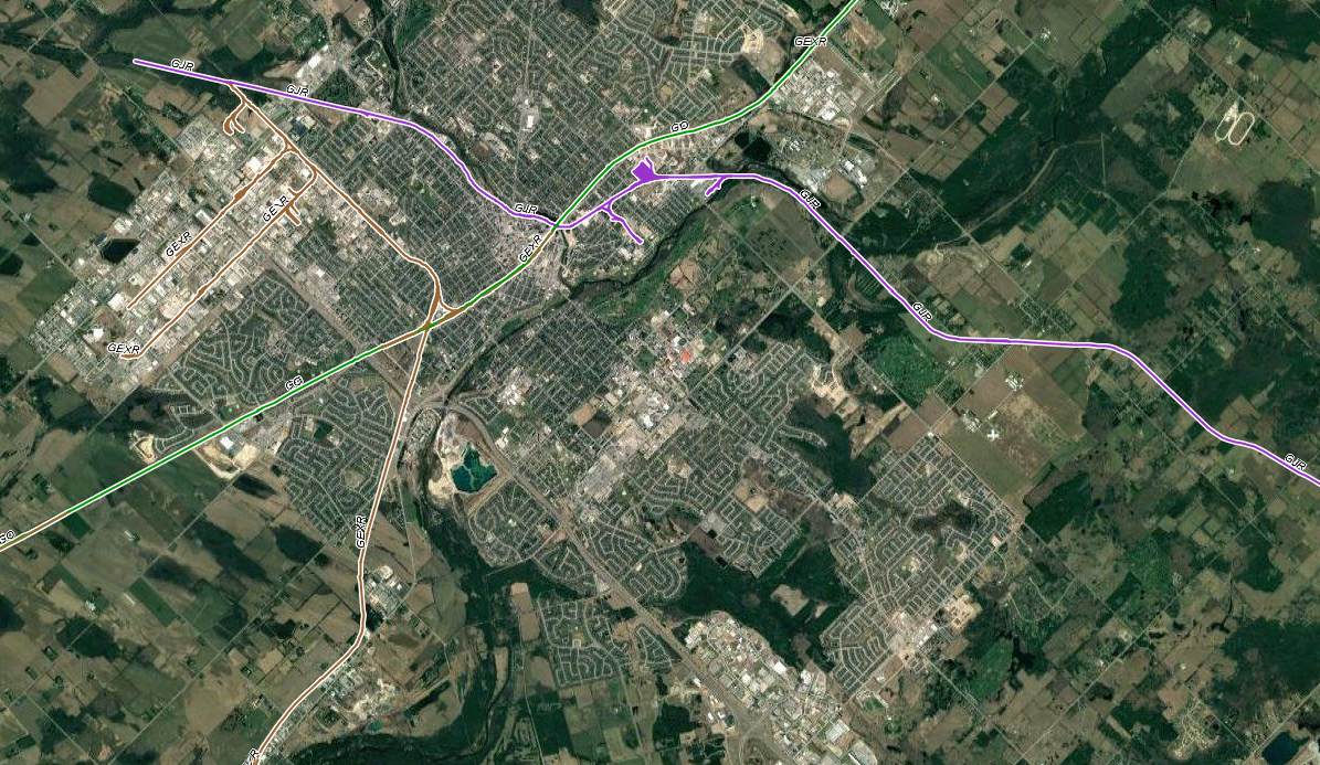

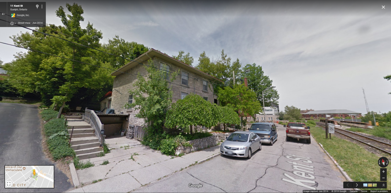

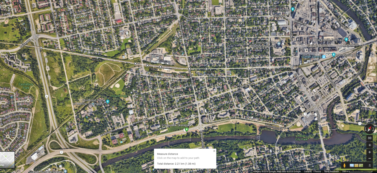

First things first: the problem area, and the absolute fixed grade points unlikely to be changed. In the east, it's Norfolk, just west of Guelph Central Station. In the west, it's the Hanlon Expressway. That's about 2.2 km.
Challenges, from east to west:
1. Guelph Junction. It's a city-owned shortline that can interchange with GEXR on the Kitchener line. Any HSR/GO changes should probably accommodate that, as having the option to interchange the GEXR (and therefore CN) or CP via the OSR that goes out southeast from the city is a strategic advantage. Try to eliminate or make it difficult to switch with one of them and the city will cry foul.

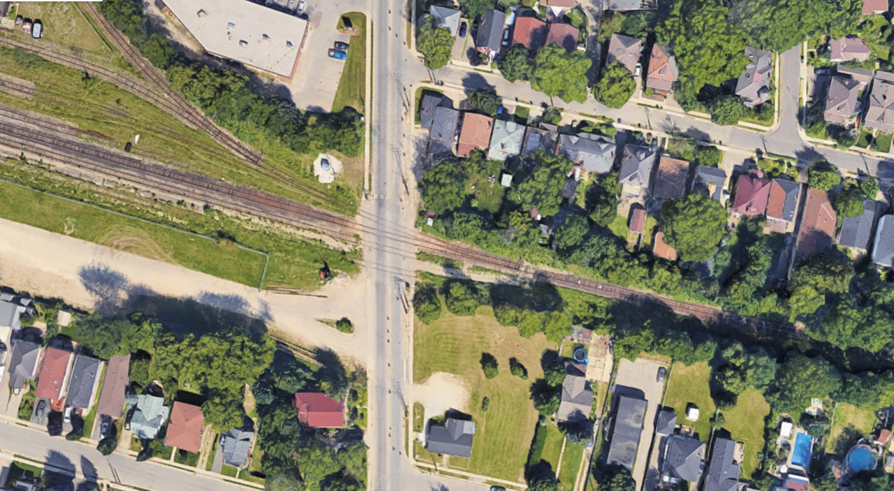

2. Edinburgh Road. This will need to be grade-separated. It is a major north-south arterial. There are also wye and siding tracks in Guelph Junction that need to be accomodated.

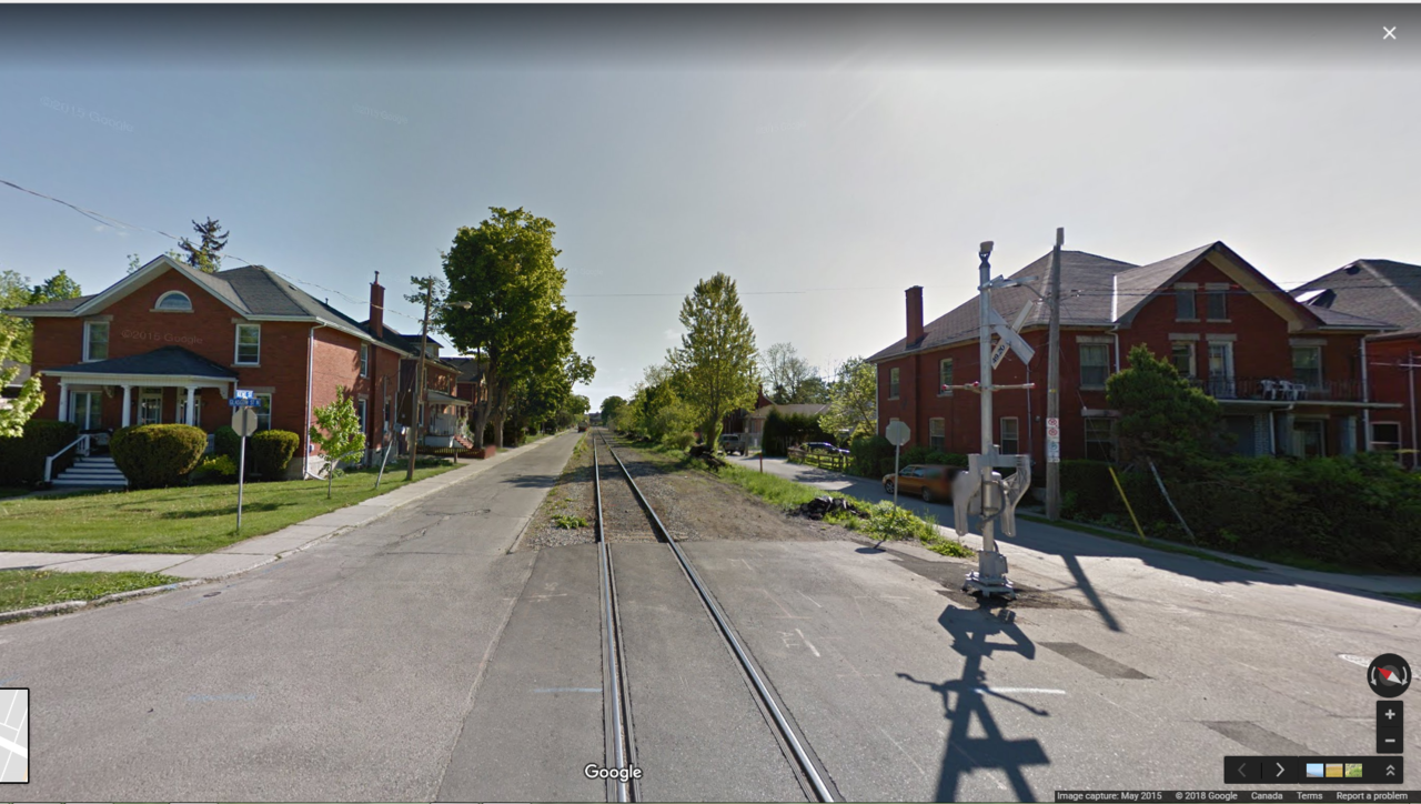

3. Yorkshire Road. A local street. You may or may not be able to close this, but at the very least, pedestrian access will likely need to be maintained. You don't want to attempt a Blue22/UPX move and propose cutting the neighbourhood in half.

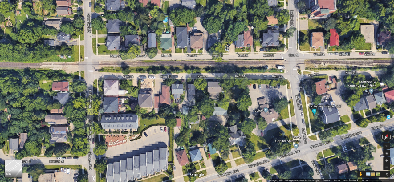

4. Glasgow, and Dublin and Kent streets.
4A. Glasgow and Dublin are local streets, arguably with the same function and traffic. However, Dublin is closer to Norfolk/Gordon (~190m), so any idea of grade-separation is just outright crazy. Plus, the hill on the north side is super steep, I've seen cars get stuck trying to get up/barely maintain control trying to come down. The argument to close it is strong, there's safety considerations on its side. Galsgow is further west, ~380 metres from Norfolk. You could maintain it for local low-height cars I think if you sunk the road a bit/raised the track a bit, the crossing is a bit raised as it over the surrounding grade. May take some driveway modification, but I think you could do it.

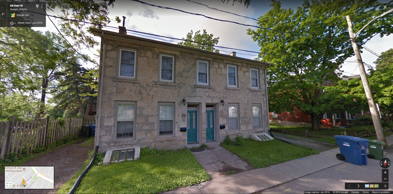

4B. Kent is two access road segments sandwiching the tracks. No way you'll be able to get 3 or 4 tracks in there (I'm assuming 2 for HSR, 1/2 for GO). You could eliminate the south segment, as it only provides access to 5 houses vs. 15 on the north side. Plus, you could maybe provide some alternate access to them via existing lanes from Dublin or Waterloo. But if the space is required, I think you could get away with eliminating the north segment too, just as long as you maintain a pedestrian pathway; it is a main route for pedestrians between the neighbourhood and the downtown. Those north side homeowners could be accommodated with compensation or some kind of parking lot. But overall, you will need to mitigate against vibration impacting some heritage homes, and place fences to restrict access to the tracks in an aesthetically pleasing way.
So overall, I think a trench or elevated tracks are out of the question and unnecessary; too much cost for little benefit. I think shoehorning a 3 track corridor through here is do-able, it's just going to make some noise and rile some NIMBYs. The province just needs to take care and effort to:
  • Accomodate transfers from Guelph Junction Railway
  • Make Ediburgh an underpass
  • Make Yorkshire a pedestrian culvert
  • Maintain pedestrian access, at a minimum, at Dublin, Glasgow, and north Kent
  • Close south Kent and either buy out those 5 property owners, compensate them, or modify access
  • Minimize vibration and aesthetic impacts

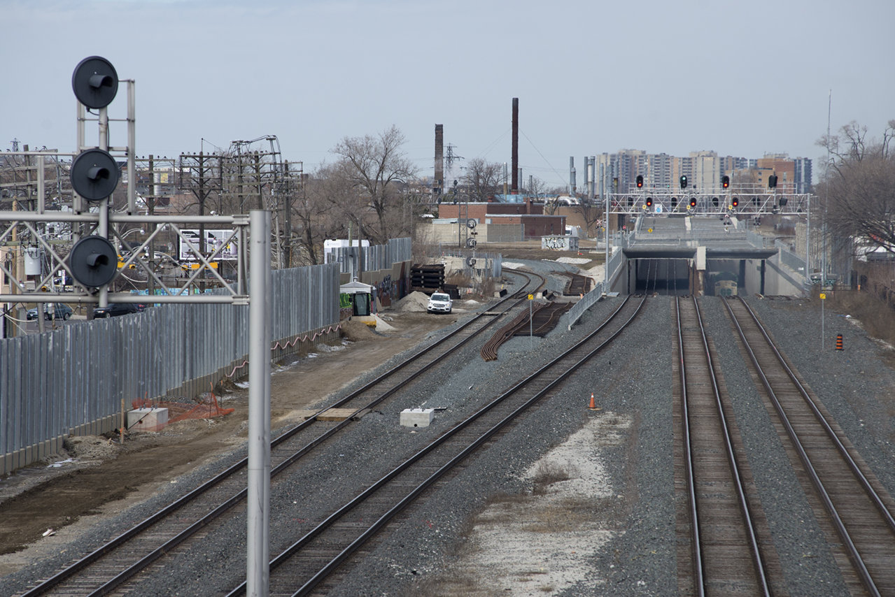

One small bit of work that is edging forward is the restoration of double track on the Milton line in the Dupont-Junction area. The second track has been relaid from the West Toronto interlocking (just a touch east of Keele St) eastwards around the bend to about Dupont St. There are two new concrete signal piers in place. When I visited on Monday, crews were working further south doing cleanup of earlier construction materials along the sound wall (ie behind the camera).
One would expect that the new track will eventually be mated with the existing track in place towards Union, and a new track will be built alongside it between the sound wall and the existing track, to mate up with the current track running around the bend to the west..
