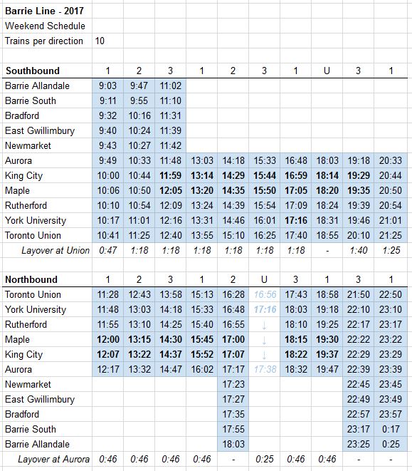

I tried my hand at some conceptual schedules showing the various scenarios.
First, the current schedule. The 16:56 northbound is a deadhead that meets the 16:48 southbound train at the York University siding. It can't be in service because there's no platform on that track.
On top of each run, I've indicated my best guess for the trainset that might be operating it. Numbered trainsets originate from Barrie yard, while "U" trainsets originate downtown. Trainsets 1 and 3 are 6-car sets, while trainsets 2 and U are 10-car sets.

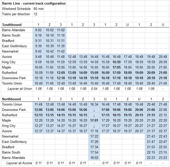

Next, the 60-minute Aurora schedule. As far as we can tell, the current plan is to move to something like this within a year.
With service moved from York U to Downsview Park, I took the liberty of switching the current deadhead to an in-service run to Aurora, which allows the Barrie-bound train to operate express, providing a very respectable 1:28 travel time from Union to Barrie Allandale - a 77 km/h average speeed.

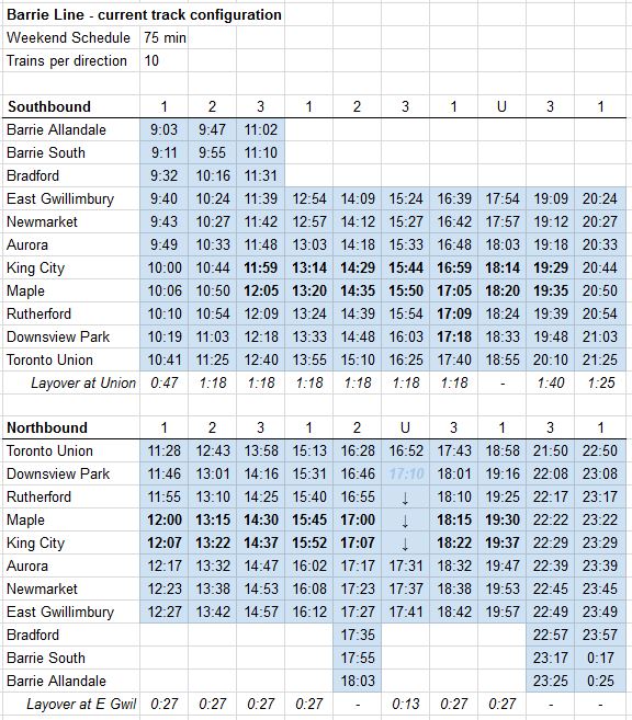

The alternative to that would be a 75-minute schedule to Newmarket, which is basically identical to the schedule currently in use, except that trains continue north to East Gwilimbury rather than sitting around in Aurora for 46 minutes. Again I've switched the northbound deadhead to an in-service express, but this time it has to be the Aurora trip based on the siding locations.
I tried to do a 60/120 turnback schedule, but I couldn't get it to work out. It doesn't seem practical to get the trains evenly spaced in both directions south of Aurora.

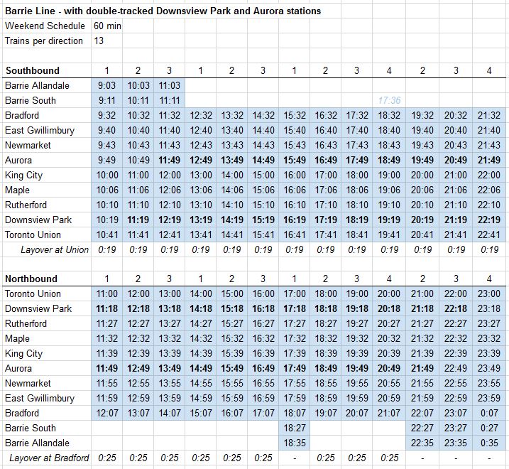

Finally, once we get double track at Aurora and Downsview Park stations, we could run an hourly service to Bradford. I've shown Trainset 1 heading back to Barrie in the afternoon, with the corresponding southbound trip being handled by Trainset 4 which deadheads from the yard to the siding at Bradford before the northbound trip gets there.
Interestingly, all four of these schedules have the same equipment requirement: four trainsets (and the last one could equally be run with three sets by not sending Trainset 1 back to the yard in the afternoon). Based on that, my guess is that their operating costs would only be slightly higher than today, while their potential ridership is far greater.

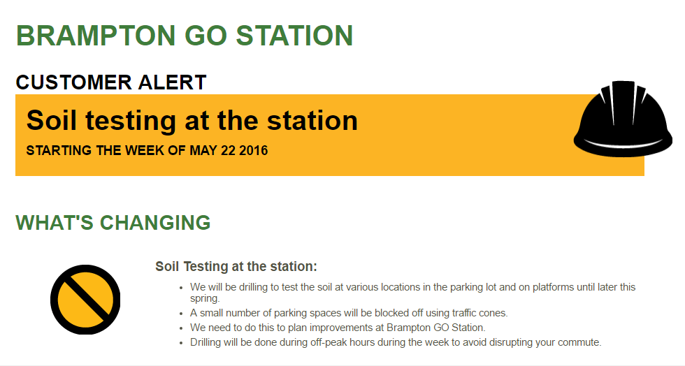

three stations on the KW line (Brampton, Malton and Georgetown) have this identical notice posted on the GO website
