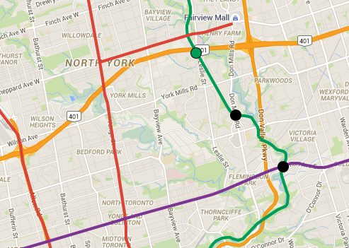

While expensive for a GO project, the chunk from Eglinton north could be tunnelled for under $2B. Compared to the price of a DRL extension to Richmond Hill, this looks ridiculously cheap for 2 exclusive tracks with very large potential capacity.
Are you suggesting it would need to be tunnelled because there's an existing trail that occupies the former Leaside Spur? Wouldn't they also need a rail-over-rail grade separation to deal with the CP Rail sub?

A grade separation would definitely be required to get to the northside of the North Toronto sub (or Belleville or whatever its called at that point). Besides getting GO traffic to the other side, it would also:
  • permit VIA to switch sides as well, if they elected to follow that right of way too;
  • open the opportunity for GO trains to use the Havelock sub to Locust Hill; and
  • Express trains to and from the future Pickering Airport.
As I and vegeta_skyline reported in the Pickering Airport sub, CP has sold northwest portions of their Agincourt yard, so there is plenty of incentive for development of the Don Branch and the midtown line east of Leaside.
I also doubt that Metrolinx would propose anything other than removing the trail in substitution for tracks. I would fully support it, but hoo boy, prepare yourselves for NIMBYs from hell.
Unfortunately, yes. It'll be a massive fight stuck for years in the courts if they try to expropriate land to run a 3-track at-grade corridor through that section. Obviously a detailed business plan would be necessary to see if it's worth while, but I whole-heartedly think it's worth taking a look at it.
I say 3-track (despite Metrolinx asking for twin) because they always seem to need 1 more track than you would think is necessary. If they twin it now they'll come back in a decade or two looking for a 3rd.
They would, travelling north, need to get from the East side to the West side as you indicate. That might occur near the tiny CP yard between Millwood and Wickstead. You can imagine a fly-under which preserves the spur to Industrial Road.
If they can't buy space from CP for 3 tracks, Redway Road, Village Station Road can be shifted to make space with only expropriations (the Esso station) and a sacrifice of a bit of park land, then Miki's Fine Linen's and the Toyota Dealership to drive through a new bridge at Eglinton.
Widening the existing corridor isn't trivial either due to numerous bridges, flood protection, and other issues; and at the end of it you still take every train on a 20 minute longer journey than necessary.
