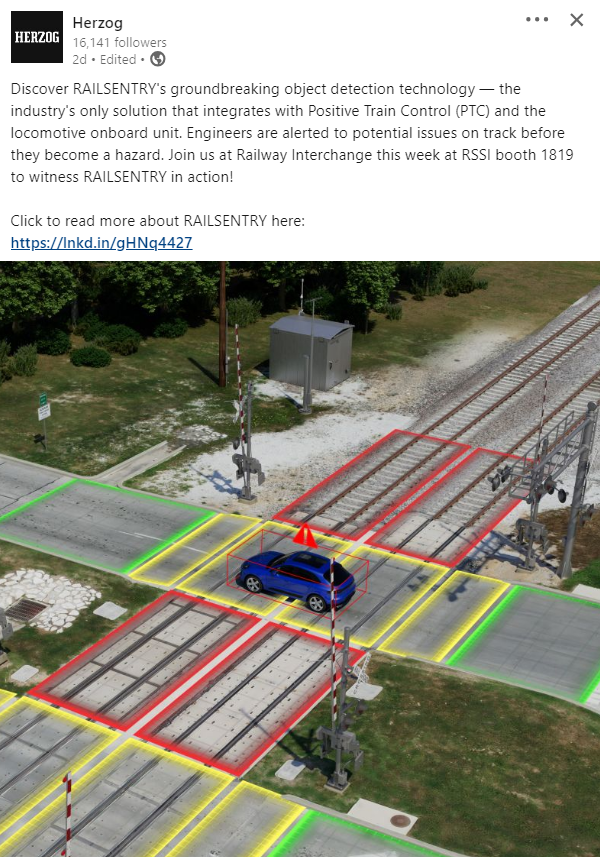

My understanding is that unlike in Europe, where cars usually get stuck between the barriers (by drivers unaware that they will fold away when you drive against them), the main issue in North America are drivers who decide to cross the tracks lomg after the warning devices have activated (as they are used to very long delays before the train finally shows up). No amount of technology will bring a train to a timely standstill when an idiot driver suddenly appears on the level crossing…
Given that the Germans equipped steam locomotives with an early version of the PZB/Indusi (installed at the O-Train in Ottawa) back in the 1930s, this sounds about right…
My understanding is that unlike in Europe, where cars getting stuck between the barriers (by drivers unaware that they will fold away when you drive against them), the issue in North America are drivers who decide to cross the tracks lomg after the warning devices have activated (as they are used to very long delays before the train finally shows up). No amount of technology will bring a train to a timely standstill when an idiot driver suddenly appears on the level crossing…
Indeed - however the automated systems may be able to shave a second or three off the reaction time, and trigger a brake application sooner, which may mitigate (but not prevent) some of the force of the collision.
The quandry for the engineer when a car crosses at last minute is whether to "soak it" ie apply a full emergency brake application, which has a number of consequences and implications, one being the train will make a painful, risky stop and the recovery process for the braking system then takes time.
Many idiot drivers do manage to clear the crossing without contacting the train (too often by a centimeter or so).
It takes time for the brakes to apply, and some railroaders operate on a "don't soak it unless you make contact" philosophy. I don't know if high speed operators eg Amtrak, Brightline condone this.
I wonder if the automated system would be smart enough to predict whether the vehicle can clear.... or decide to first make only a full service reduction, which can be cancelled more easily, sooner, if there is no contact.
