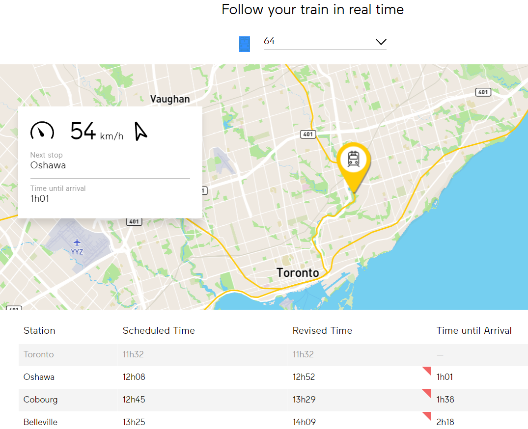

I’m just wondering what’s going on on the Bala Sub (Richmond Hill line) today? There’s been an unusual amount of trains passing by for a Saturday. At least 4-5, that I’ve heard by now around Sheppard Avenue.
All VIA trains east of Toronto are being detoured due to track work at Scarborough Station. The trains eastbound are heading up the Bala to Doncaster, then east on the Halton Sub to Pickering where they rejoin the route. The westbound trains are doing the opposite.
