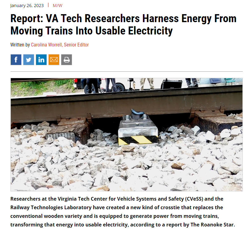

Interesting concept - the question is, how much of the energy obtained is “waste” energy eg would otherwise transmit to the track as vibration, versus how much is a parasitic load that represents resistance to the train’s passage. If the latter, the locomotive will have to make up the energy by burning more oil, and we would have replaced a solar cell with fossil fuel.
This is a very promising development, and hopefully bears fruit - but the most important sentence in the article is
“Extensive research and development work to adapt the vehicle to American infrastructure and standarda”
In other words - still lots of work before it’s ready for prime time”
As a concept it is not particularly new. So-called 'energy sidewalks were conceived about a decade ago; some using electromagnetic induction, others were piezoelectric. I'm a little surprised in this case that they went with a mechanical linkage, to turn a generator, which strikes me as maintenance-intensive and more prone to failure.

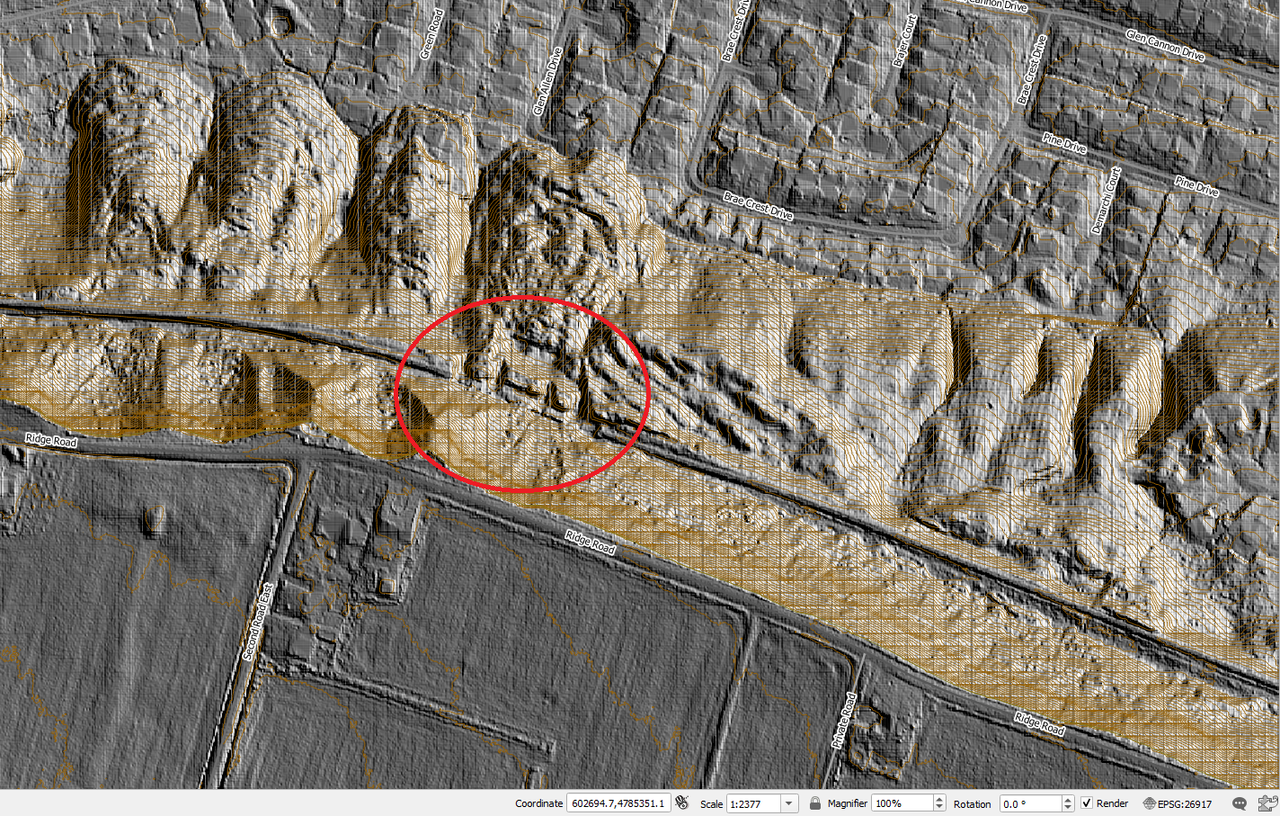

I took a walk along CP's Hamilton Sub today. My most curious find: I assumed it was a consistent cut/berm down the escarpment, but I discovered an interesting bridge structure along the way (couldn't get a clearer shot through the trees).
You can check out more here.
Those 'bridges' are fairly common on steep hillsides - I have seen them for both railways and roads.
I guess I just assumed they had enough of a cut into the slope, or an earthen berm where it fell short. Even a retaining wall if it was necessary. I just found the choice of a bridge this long, where it wasn't even that steep, to be an interesting choice. There wasn't really any water flowing under it either, though the gullies suggest that wasn't always the case.
That is effectively a "bridge", although the gentle gradient means it really isn't very far above anything.
I don't have any material at hand to determine the point, but I would speculate that it might have originally been built as a wooden trestle, which would have been much faster and cheaper to erect than excavating around the topography. Possibly the rock conditions would have required that excavation to be quite extensive, and carefully sloped to prevent rockslides.
And the downhill geometry might have favoured a trestle over filling in as an embankment.
And then, at some later date, it was cheaper and more expedient to replace the trestle with a freestanding "bridge".... and the life cycle of a bridge is long enough that no one is going to revisit all that for a very long time.
It might have a lot to do with stability. The escarpment is primarily sedimentary rock which typically cleaves on the horizontal plane and can be fairly unstable when cut into; i.e. it doesn't settle or pack well. Add in groundwater and they might have learned (here or elsewhere) that they couldn't maintain a stable bed without constant shifting and maintenance.
