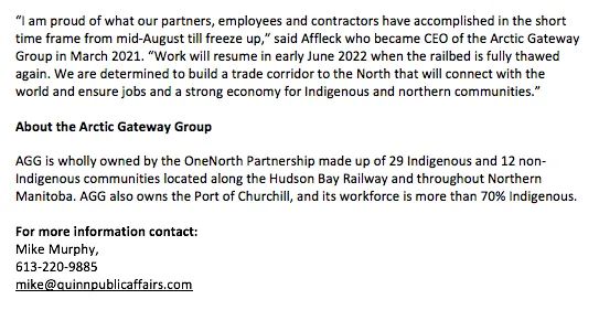

Good news about Churchill. Though perhaps not the best timing with all the supply chain issues.
But glad to see they are doing this right! Bodes well for the future. I wonder if that could lead to travel time improvements.
The navigation season at Churchill is pretty much over for this year, so I don’t think this is really much of a delay… more just acknowledging that work can’t be done over the winter season.
