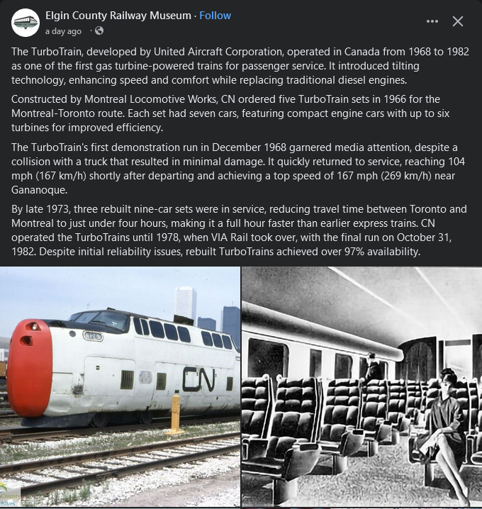

Saw this on my FB feed:
What caught my attention was the suggestion that the train reached 269 km/per hour.
I don't recall hearing that.......in any event that's far above permitted track speed today for any passenger train in Canada.
So I wanted to tag our rail experts/historians like @crs1026 and @smallspy to see if I could clarify if the train actually reached such speeds, and whether that was acceptable under
regulations then.
Edit to add: Subsequently, I looked up Turbo Trains on Wikipedia; the article there quotes a much lower peak-speed achievement, and notes that was also done only for its inaugural run.
That still leaves me curious, since there is a discrepancy as to what top speed was reached; and even outside of regular service, I find it curious that such an attempt was permitted, contrary to regulation.
regulations then.
It was a speed test in the late 1960s under controlled conditions, without other trains present. Nothing unusual about that - I've certainly seen (and we've discussed) Flexity speed trials on Queen Street, which must have at least hit 70 to 80 km/hr in a 40 km/hr zone.
regulations then.
As usual, the history has been blurred somewhat by rose-coloured glasses and boosterism....
The speed listed in the post is wrong. The American TurboTrains did a similar speed test as the Canadian ones in the late 1960s, and managed to achieve 167mph. The Canadian ones, by virtue of being longer (and thus heavier), and with less track to take a run up, "only" achieved a top speed of 140mph.
It should be noted that was a test run solely for publicity purposes - and only because Bombardier's LRC demonstrator (with help from CN's competitor) had reached 139mph a couple of months previously. Rather infamously, police officers were posted at all of the level crossings (as the gates would not come down in time in advance of the train's arrival at many of them), and all switches were bolted shut. The mileposts listed correspond to the Kingston Sub between about Cardinal and Crysler - Morrisburg almost perfectly splits the two locations at 92.2. In revenue service, the train was limited to 95mph, and lower in a lot of places due to track geometry - just like the trains of today.
The reality is that the TurboTrain was faster than any other train on the line, but not significantly so - and that was mainly due to not having as many stops. It was originally timetabled at 3 hours and 59 minutes, and very quickly it was realized that was overly optimistic - for much of its life it was timetabled to make the runs in 4 hours and 29 minutes. The sub-4 hour time was only brought back with the LRCs in the early 1990s, and at that point only once per day - whereas the Turbo did it twice-a-day.

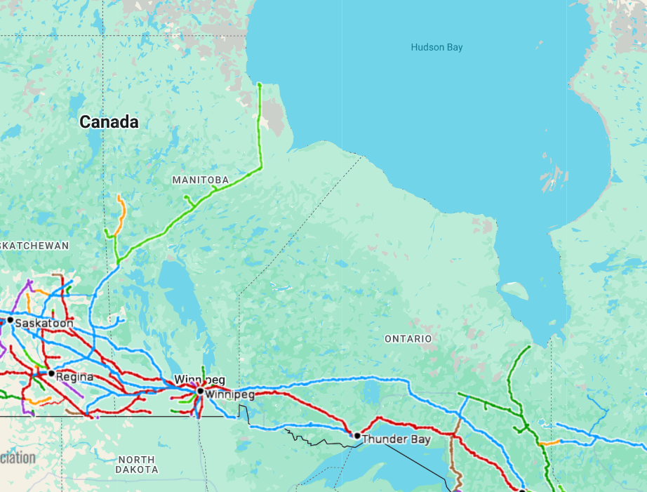

I wonder if a railway from Moosonee to Churchill has ever been considered? With no roads, it could connect communities and possible commercial/resource expertise along the Hudson Bay shoreline.
Very cool, thanks for sharing that.
To what purpose?
The Churchill line has a much clearer case as a direct and competitive route for the export of Western Canada output, especially grain.
Ontario has much less bulk material to export and the route to Atlantic ports is already pretty good.
Sure, one could draw the line on a map…. But it’s a high cost and not likely to present a return on that innvestment.
