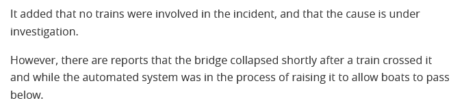

I’m really curious what happened. Bridges usually don’t collapse, especially without carrying any loads…

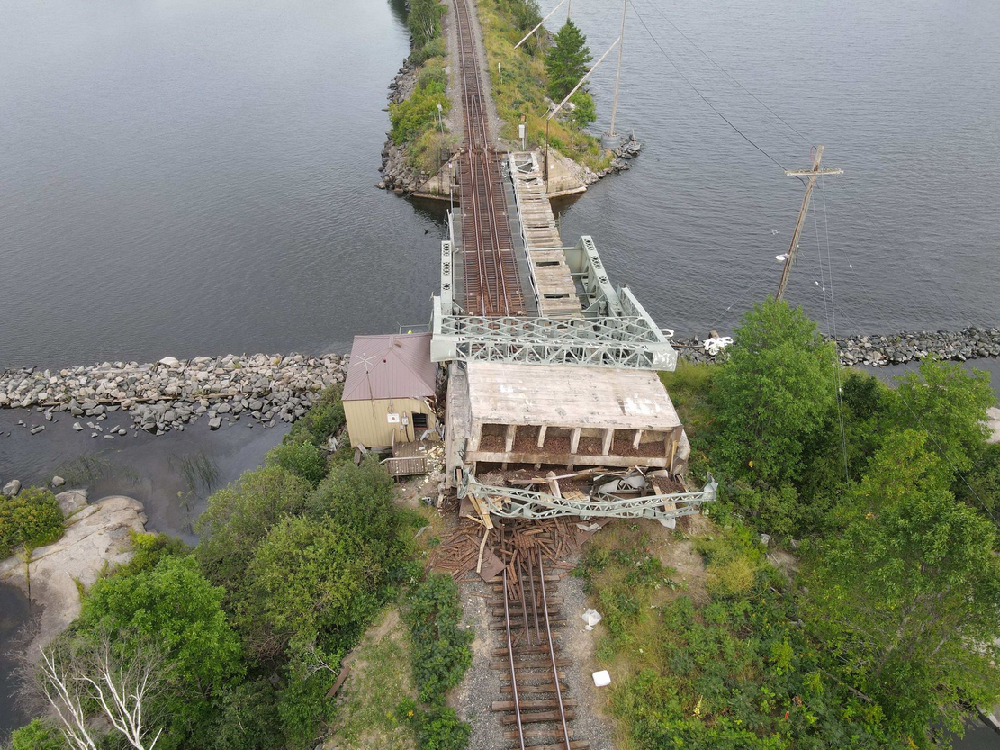

From here:
This:
Not a complete answer, but perhaps a clue........
Another pic:
Source: https://www.fox21online.com/content...29-3412409745726460-6104086313984956613-n.jpg
Pic courtesy Rainy Lake Property Owners Association
From here:
This:
Another pic:
There appears to be a camera on the pole to the right so hopefully they will have some images. Pure speculation but it appears to me that the counterweight support collapsed and when the bridge deck slammed down it bend its back.
The ties on the nearside look pretty random and not well ballasted.
