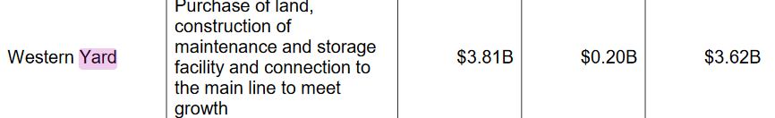

Hypothetically, even if a new yard costs $1 billion (you provided this number) to be built somewhere on Sheppard East after it's extended, you're still saving $1.8 billion to be used elsewhere.
I was being VERY conservative.
Here is the capital budget line item for the new Obico yard for Line 2:
Source: https://www.toronto.ca/legdocs/mmis/2022/ex/bgrd/backgroundfile-199568.pdf
And the line is right there, more or less.
By comparison, the only place an eastern yard is going is CP's existing Toronto Yard. Assuming CP agreed to sell some or all of that yard to TTC, the connecting track would be significant back to Sheppard.
