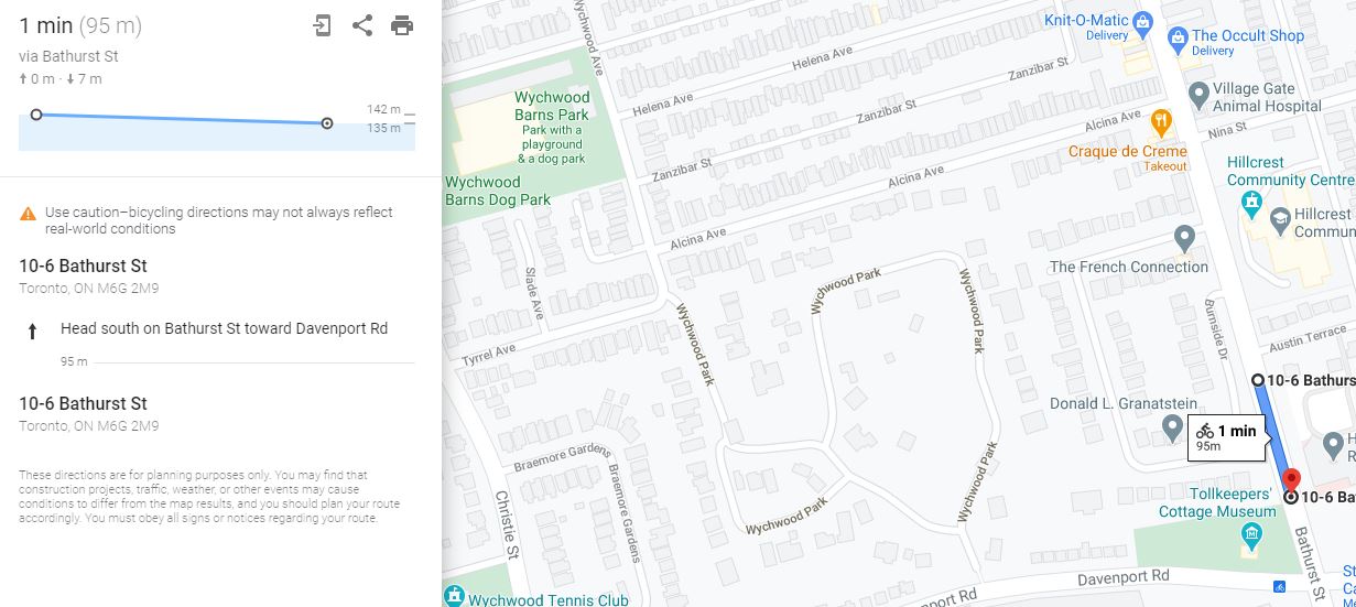

Someone can correct me I but believe the incline should be manageable. The incline on Bathurst south of St Clair is very steep and I assume they keep streetcars rolling up and down Bathurst in winter.
It's quite difficult to gauge the difference in the slopes' gradient.
I tried to use google's bicycle route planning to do an estimate.
These should be the steepest slopes on those roads:
~11.5% slope
~7.5% slope
I don't think that's the steepest spot on Bathurst.
You can go to the city's GIS-based maps on their website, turn on the topography, and just measure the slope. In a thread somewhere I already did that for Bathurst.
~11.5% slope
~7.5% slope
Wow, I have been on the Finch bus and I didn't notice anything steeper than that bit on Bathurst.
