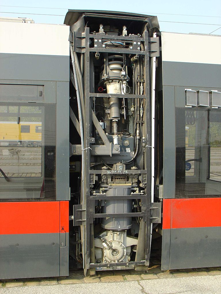

The point is to prove that yes an Low-Floor LRV which doesn't have seats compete with the wheels and other stuff can be built and has been. However it never took off because of the sheer complexity to maintain. As well the ones used in Vienna have to contend with narrow European streets so the loading gauge his limited heavily. This isn't a problem here since streets like Eglinton are far wider and thus loading gauge can be much broader. Regardless in the case of high capacity LRT lines, High Floor LRV's are superior to Low-Floor ones but that's not what we went with.
Just as an aside you can see in this picture where Siemens crammed the motors for those LRV's (this is why nobody really uses these trains). As well the trucks are located under the articulated joints instead of under the cars themselves like with our LRV's. This does mean that segment length is shorter for balance issues but ultimately the length of each individual segment doesn't matter when compared to the overall length of the train.
The kinematics of this are horrible, they have to operate as servo drives with precise control over wheel position to maintain the bogie angle with respect to the individual sections. I'd be surprised if they could even be towed without power.
I'm glad we didn't pay for anything like this.
Edit: Did some digging, there are mechanical steering linkages, but there's still fine grained and finicky motor control to balance torque when the vehicles are running straight.
It seems like an over-engineered solution to a problem that really didnt exist in the first place to be honest.
All for a slightly more spacious cabin. Wow.
