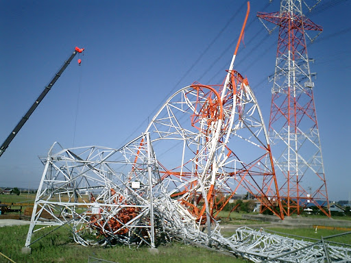

I don't think Hydro One wants to be liable when this happens when one of the articulated buses, packed or half gets crushed under this
