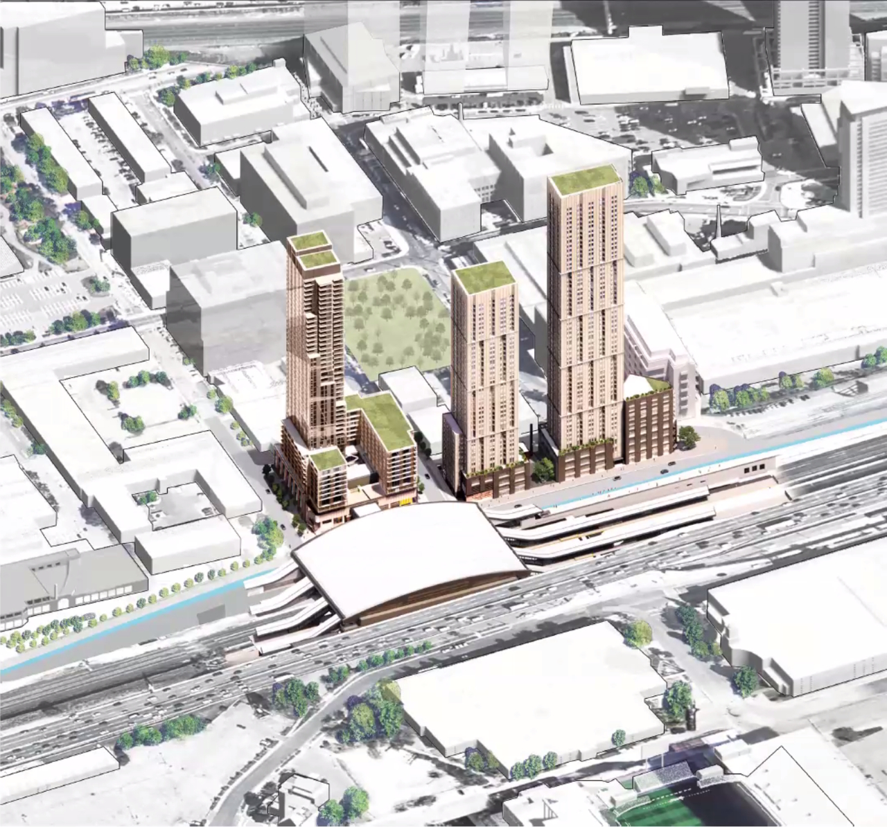

Big height & density boost here! Check out our front page article for details and additional renderings:

If there's a place for density in LV, it's here or nowhere. Direct integration into the future Exhibition station is exciting and will transform how the community moves through this neighbourhood. Full steam ahead.
I don't like the current iteration.
I have no inherent problem with the height, but they've got two E-W slabs directly south of what will be LV's only substantial park in the western 1/2 of the area. That will block a lot of light.
The problem is easily solved if you turn the slabs N-S, but I imagine that would require additional land acquisition.
The towers are over 100 metres south of the park. I would want to see the shadow study to confirm, but shadow impacts are likely pretty minor and limited to shoulder seasons and in the morning hours.

To calculate shadow, you need need to know the sun's angle, relative to Toronto at a given time of day and at a given time of year.
So for June, the sun is at 70 degree angle at 1pm
A 40 degree angle at 9am
A 40 degree angle at 5pm.
At the 40 degree angle, the shadow of a 150M building exceeds its height, ~178m
At the 70 degree angle, the shadow is only 55m.
For June, this aligns with your expectations.
But in September the sun's angle at 1pm is 45 degrees, indicating a shadow of 150m
A further note, if this is built, as proposed, you would imagine it triggering additional density to the north would you not? Then you get into those shadows as well.

Given a few posts I've seen in the Liberty Village Residents Association Facebook group, residents have been actively crowdsourcing parks in the area that provide full shade during the day because they don't want their children out in the sun and the existing parks have too much sun. I'm sure they would welcome this park having more shade.
That said, at the consultation, IO did say tower placement was done with attention to shadowing of the park, with an aim of minimizing it with the location of the tallest tower at the east end of the site.
Good to hear.
