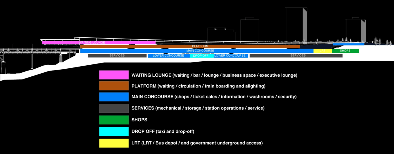

I'm glad this wasn't built. It doesn't make sense to have a major passenger train station right next to the legislature. We need to maintain some distance around the legislature for ceremonial effect.
That stretch along 109st would be ideal.
LRT connected, LRT to CBD, multi-use trails, major arterial, walkable to good density, the Leg, UofA, MacEwan etc. etc.
The bigger issue is the impact to those backing onto the tracks on the south side from 109st-104st.
There still are several parking lots along 109 St, just north of the Leg that would probably actually make a good location for something like this.
