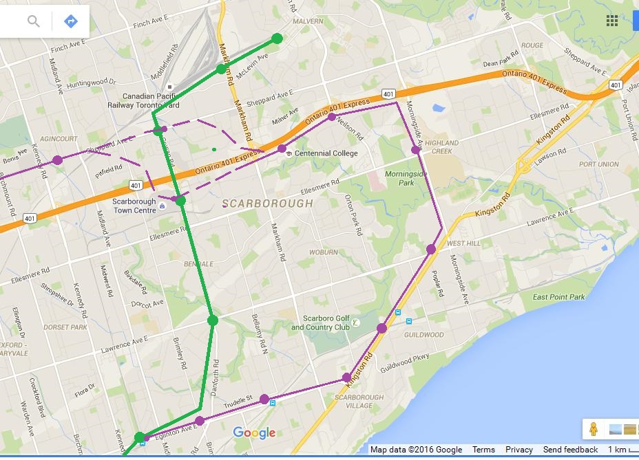

Probably in the fantasy land, but if it can be funded then I would try something like this:
Assumes that Sheppard is converted to OL type technology, or another kind of mini metro. Then it can be combined with Eg East. It would run elevated along Eglinton, Kingston, and Mornigside. Segment next to Hwy 401 would be at grade, with a bridge over Neilson.
The dashed lines mark two possible ways of connecting to Sheppard: either via STC, or via Sheppard & McCowan. That segment might be partly tunneled.
This route would help with the Eglinton demand, and at the same time, connect Sheppard with Lakeshore East GO, and connect both Sheppard and LSE GO to UTSC and to the Centennial Progress campus.
If the Crosstown cannot continue through Kennedy I would suggest this. But, Metrolinx seems to claim that the city is incorrect, that the Crosstown can indeed continue as one line past Kennedy. If thats the case, I'd have the LRT go along and up to Morningside and Sheppard and meet the Sheppard subway.
But otherwise I really like this idea, I never thought to continue Line 2 to Malvern

I agree, connecting the Crosstown with Eg East would be of the greatest benefit.
But, that might be difficult, according to the post by Northern Light:
And, according to Steve Munro's article:
It seems Metrolinx didn't tell the whole story. The kept the alignment of the subway tunnel, hence what they said is technically true. But, they changed the design of the tunnel in a manner that obstructs the connection between the two light rail lines.
Honestly this is not my idea, I've seen it earlier on this forum. And I like it, but it is conditional on being able to extend Line 2 at-grade on the south edge of the rail corridor, and thus to avoid extensive tunneling.
That would substantially increase the cost compared to an in-median LRT as currently proposed. Highly unlikely to happen.
That would increase the cost, for sure. But less likely to happen? nobody knows.
