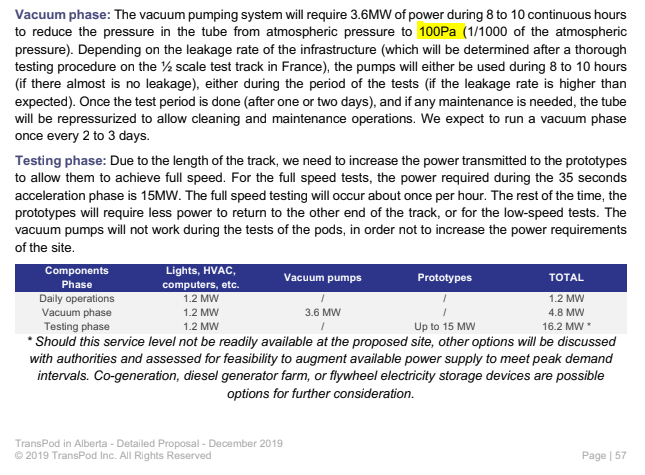

Two Major things -- 1. the Hyperloop is not intended to create a vacuum in its conveyance chamber and that is where @Aaron_Lloyd's source got it entirely wrong. Hyperloop is intended to create a pressure differential only (a partial vacuum in the direction of travel) to drastically reduce air resistance at high speeds. The effort to create a complete vacuum is so ludicrous that the speaker in the video needs to reread or re-engage with his sources. So-o-o-o-o many people make the same mistake! A complete vacuum would whip the internal module at lightning speed -- completely out of control -- basic high-school physics tells us that. Besides if the internal module doesn't touch the wall of the enclosure what use would a complete vacuum be? An air density differential, however would make the system capable of attaining high speeds in a completely controllable fashion -- the same kind of differential (Bernoulli principle) that enables airplanes to fly. The lesson -- don't be misled by people who don't know what they are talking about. 2. There are many Hyperloop test scenarios going on around the world (does one think that major investors in these projects know nothing of where their money is going? C'mon guys!) Here is a more balanced reporting -- https://www.cnn.com/travel/article/how-long-hyperloop/index.html
The original technical paper (pg 12) calls for the tube to be depressurized to 100 pascals (aprox. 0.001 atm) which seems to be what the video used as the basis for making its assessment of the system (based on 9:25 in the video). Maybe there's been development since then that calls for a more reasonable spec, but I haven't heard anything about that if that's the case.

So I took a look at Transpod's proposal doc (request your own copy here), and it seems they are expecting the same low pressure of 100 pascals criticised in the video I posted. I don't know how the show stopping concerns raised in the video could possibly be overcome to produce an affordable and safe transportation option.
