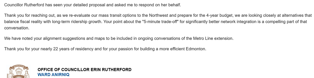

So guys, remember this email that I sent to Councillor Rutherford? And also to Edmonton Transit Riders? Well, I got a response from Rutherford's office:
Nicely done, glad to hear they are keeping their minds open on this.

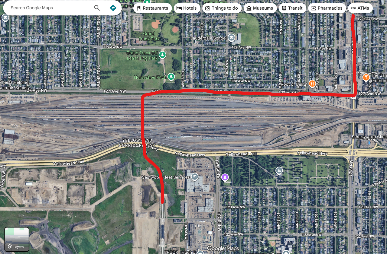

A solution that will either satisfy everyone or make everyone equally upset.View attachment 738776
Honestly, this design at least somewhat shrinks the cost of the bridge over the CN Rail by going through the smallest stretch possible. Thank former airport for the little bump.
What benefit does that route have over a cheaper bridge at 97st though? Doesn't seem like it really solves a problem.
Plus many of the 127av residents would probably complain about the added noise, while the cemetery residents south of YHT will not.
I mentioned before about the sheer difficulty of aligning the Metro Line with the YHT, where there's just no possible way to fit into the already tight squeeze between the cemetery and the CN Railyard. One person suggested that the LRT goes into the YHT median and just elevate it to compensate for the tight 6 m squeeze, which, um... that idea sounds so expensive and complicated you might as well do the bridge over the railyard, and I'm sure the city would not want to do any more work on the YHT with the freeway conversion they're already doing.
As for the 127 Ave residents, just stick a noise wall there. Really, my idea would have to completely close 127 Ave for the LRT. Small price to pay, comparatively. Even better, maybe there's a small chance that the CN Railway gives up the northernmost rail line for the extra space.
