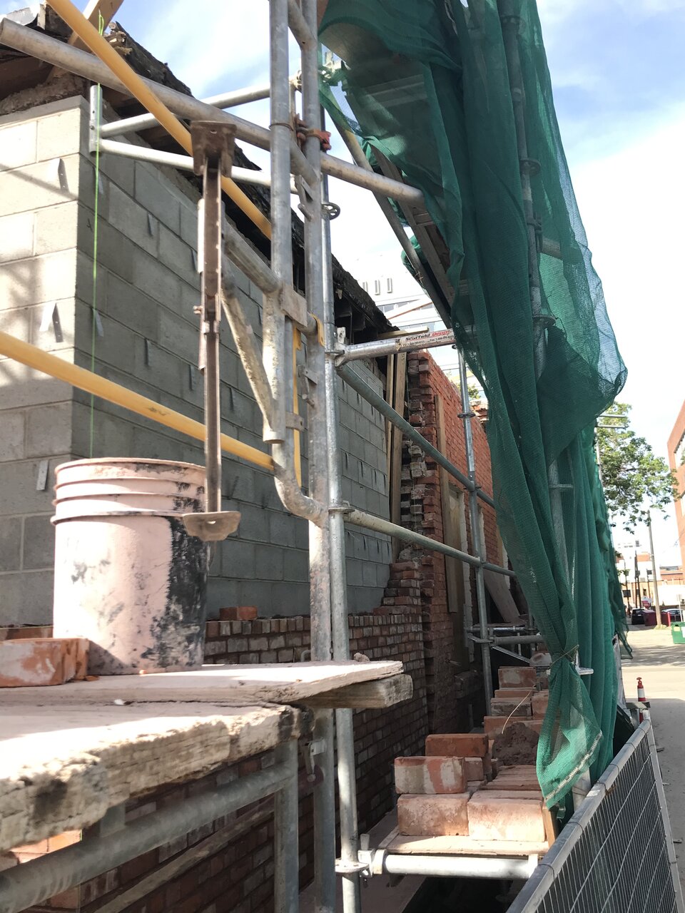

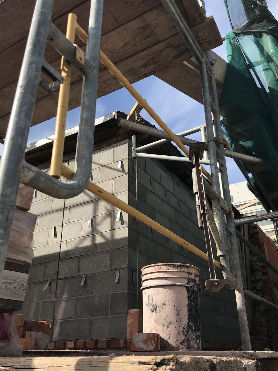

I was going by there today and i noticed the flat-roofed portion is being rebuilt. just the south end, which was looking really rough before. I was suprised to see how it is being rebuilt, using 8" CMU and 2 rows of historic brick, laid up all together as a monolithic wall some 16" thick. I thought this setup, particularly the lack of a modern rainscreen/air gap, really odd, and I guess it's gonna be insulated inside? i also noticed that the original roof structure (steel and concrete slab, with wooden furring and decking overtop) being retained, even over the new walls.
My puzzlement, i guess, is how extensively is the building being rebuilt/restored? The retention of the original roof, even when the walls that support it are being replaced, and the used of unusual monolithic masonry walls instead of modern insulated walls with masonry veneer, seem really involved (and expensive). That being said, if the intention is to retain the integrity of the building and keep it as historically accurate as possible (chilly thick masonry walls and all) what's being done makes sense. Does anyone know what the plans are for this building, is it supposed to come out of this work in it's 1910-whenever state, museum-ready?
