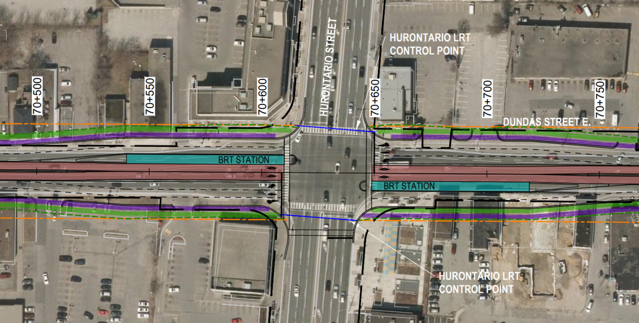

How will there remain two lanes in each direction and a brt lane at hurontario and dundas.
Looks like demolition. From the initial draft design.
Notwithstanding the plan they have, if they wanted to avoid demolitions they could just ban left turns at the intersection to buy themselves two lanes. Then either implement a u-turn somewhere down the road or make it clear u-turns are expected at the next intersection.

The city has the power to force the owners to demolish their properties in order to make more room for the brt? And at the same time the city has the power to reject common sense development heights? How do those two things work together.
In theory, they could limit the demolition to one side of Dundas to widen the ROW up to the OP width of 42m. My guess would be the south side.
Given this is a design build contract, I think the decision may be made by the winning consortium.
Will they fall on their knees and genuflect as they give single--occupant motorists their left turn ahead of the crowds on board the bus trying to get to the other side of the intersection? Or will they have REAL transit priority traffic signals?
