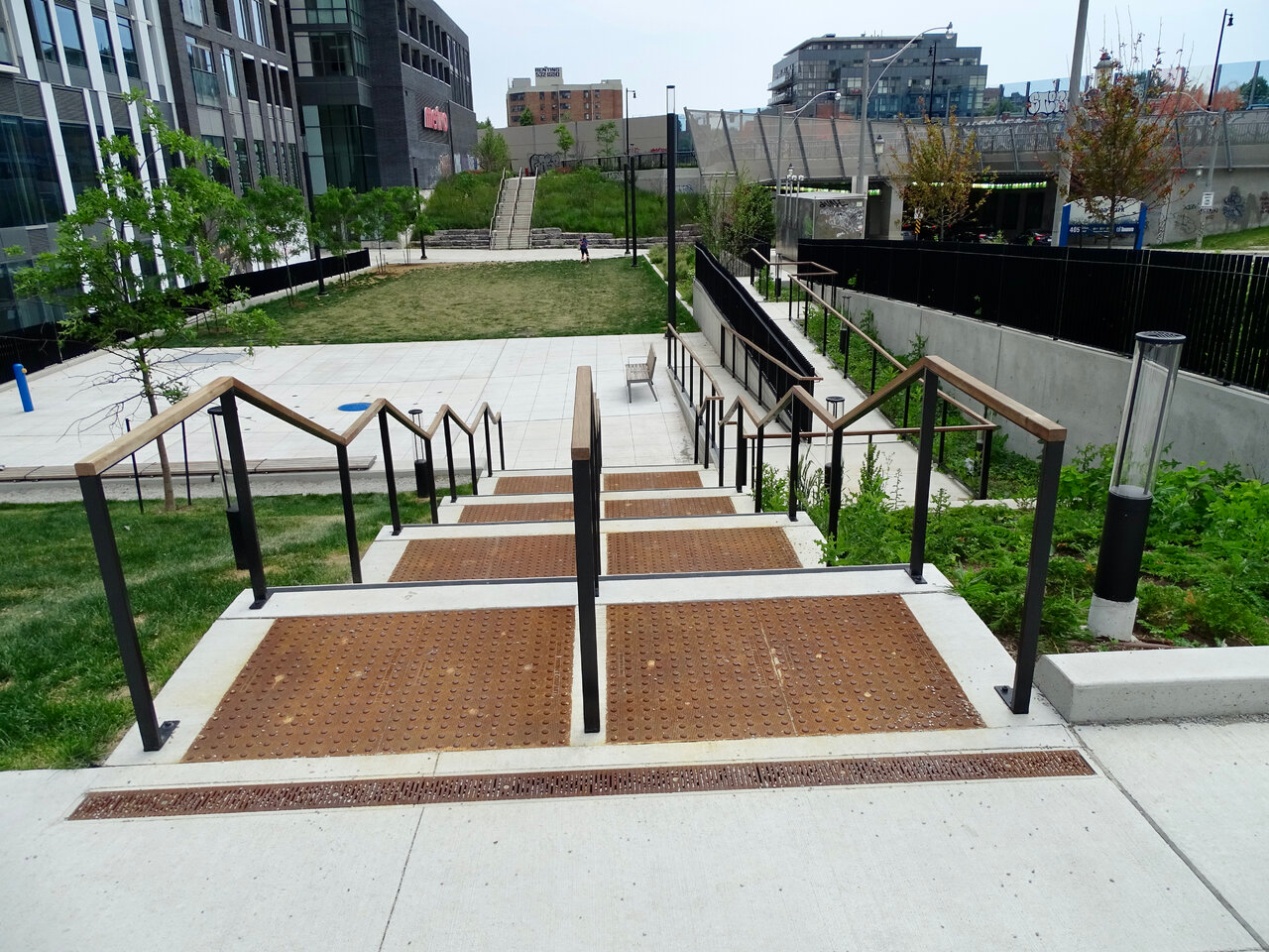

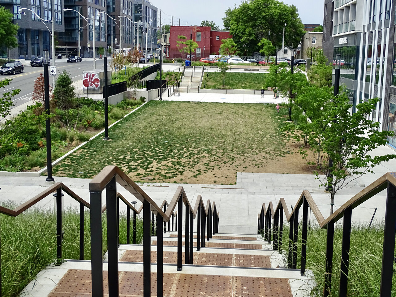

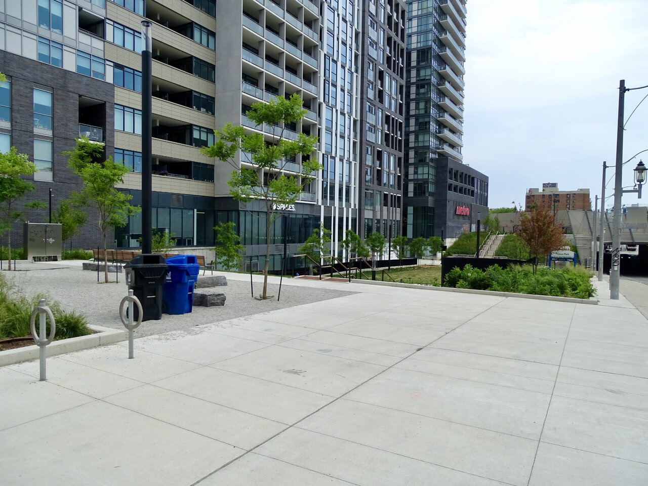

@#$@ me!
Bring me the project manager!
Bring me the designer/L.A. !
The trial begins now!

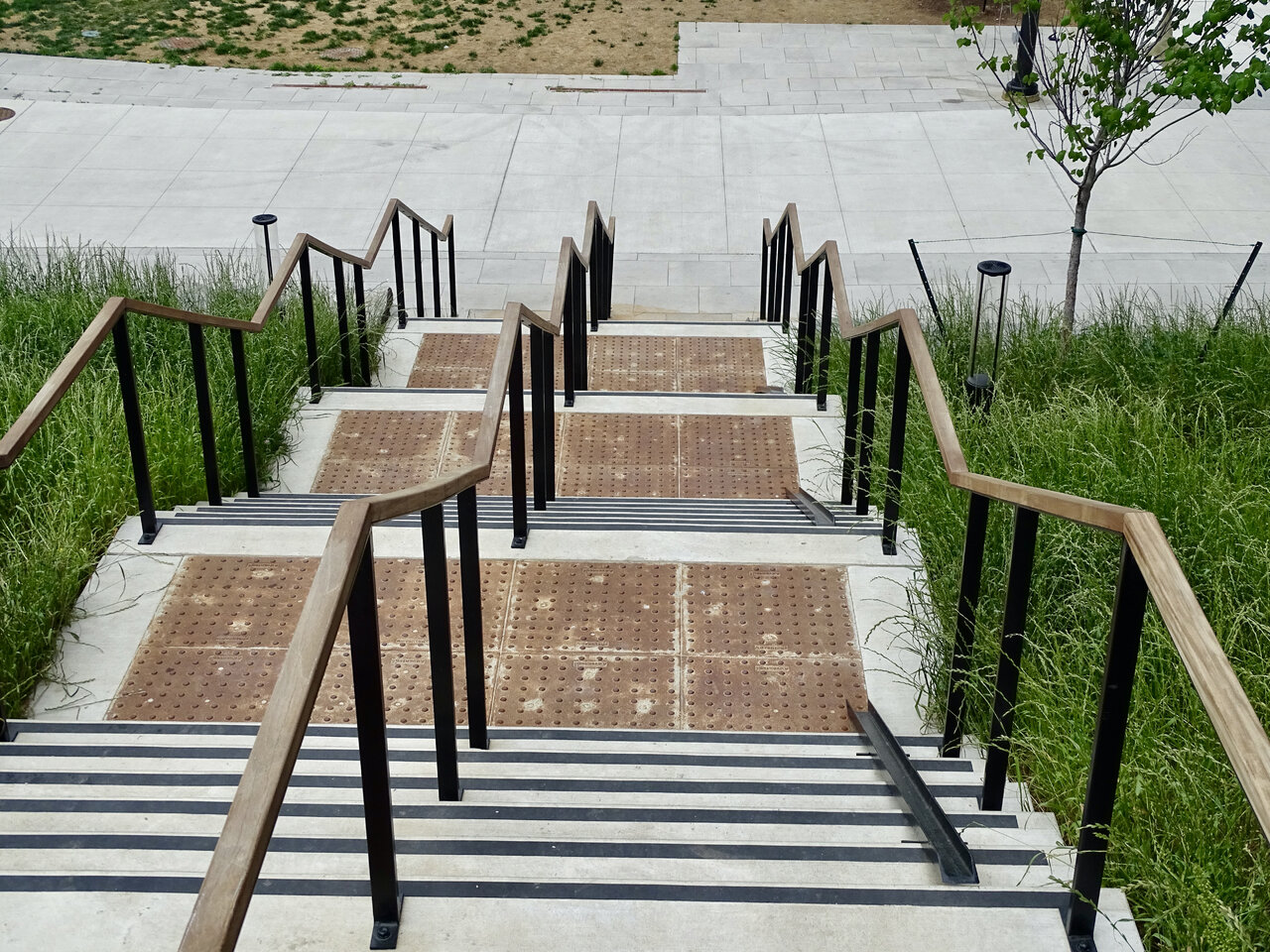

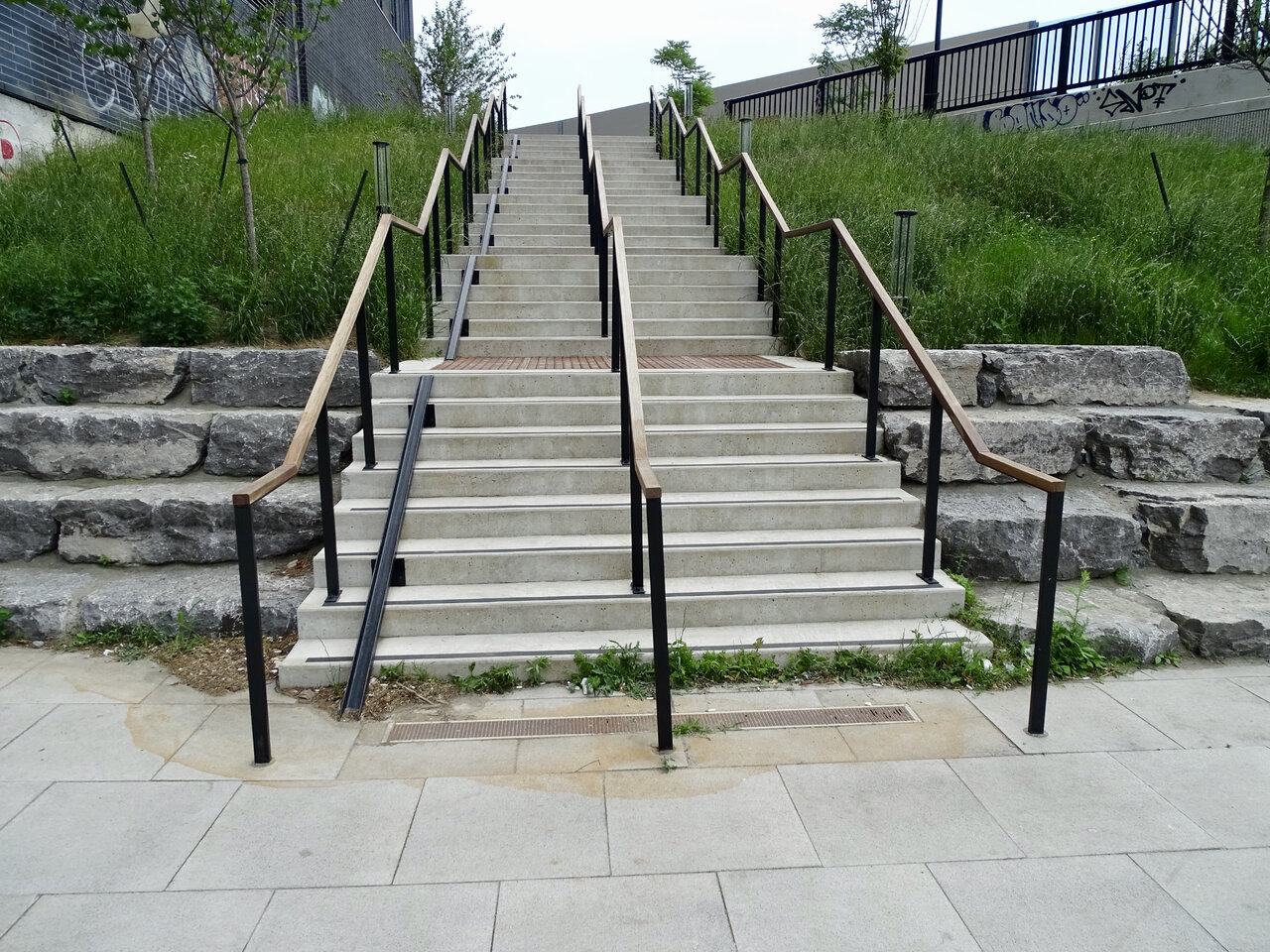

FFS..........corten steel on the stairs? Really?
That stain on the concrete at the bottom..........do people not understand how this works?, really?
The grass at the top is an unmaintained weedbox.
The grass at the bottom has been beaten into non-existence.
That's my @#$# money, going down the toilet!
In three parts.......
1) The Corten...........there are other choices that are easily recognizable to the visually impaired, and which vary in texture and are non-slip. Many forms of granite are excellent for this.....
Just no!
2) The weedbox at the top...........I'm fine w/low-maintenance spaces. Though, no maintenance rarely works out.
But plant something aggressive that will give a uniform appearance and put up w/the stresses of the site.
3) The beaten to the death grass at the bottom.........
credit to @Red Mars
This is not hard..........look at the line from one staircase to the next.........what is the most efficient route..............right..........duh!
Also...too small a space for grass to be durable unless it's protected and irrigated.
It is certainly not the former and doesn't appear to be the latter.
Wrong treatment!

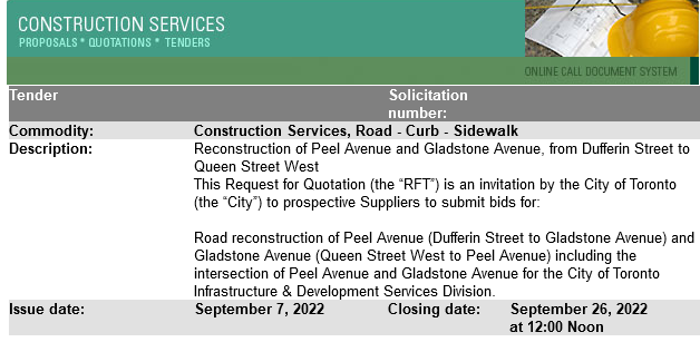

The Peel-Gladstone re-do is now out to tender:
This project was scheduled to be done this fall; due to the delay in getting it tendered, it is now scheduled for spring 2023.
