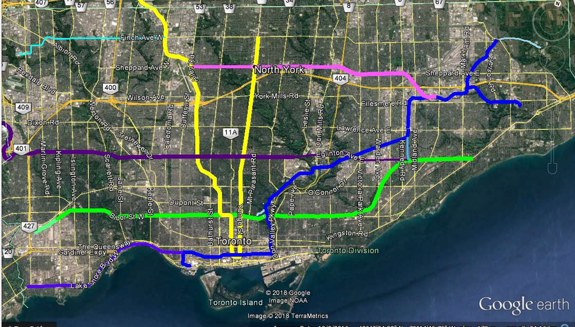

I was imagining gondola to connect the Blue Scarborough line (the replacement for the SSE) to Castle Frank station on the B-D line, to connect to Kennedy Station, and to connect to the zoo.
