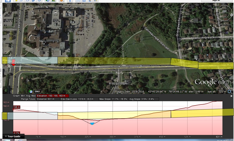

The solution is not elevated, it's a Bloor viaduct style solution.
At Lawrence, the subway is underground about 5 or 6m.
It crosses Highland Creek at about the elevation of the current road bridge*.
It goes underground on the north bank between the hydro lines and St. Andrew Road.
The roadway goes directly on top of the subway.**
* - the elevation of the bridge may have to be raised to pass the Regional Storm (Hazel) under the bridge. Currently, it is likely designed that if a Regional Storm comes, it overtops the roadway and possibly washes out the north approach to the bridge. This idea of mine creates a 5m high bridge which could act as a dam if the water level gets too high, and may back up water levels upstream. However, the Sheppard line over the Don Rive solved this.
** - there needs to be some small changes to the roadway. Likely Benliegh Dr. would have to be realigned, or keep a low level bridge to the north of the subway bridge that gives access to Benleigh only from (and to) the NBL.
I show this new subway bridge (and road bridge) just west of the existing, because its construction may lead to less traffic disruption.

The tunnels approaching Lawrence are incredibly deep. IIRC, TTC doesn’t permit grades of more than 2% for stations and 5% for tunnels. So for an elevated structure, it would have to rise to the elevated level, and descend back to tunnel level, within those grading constraints. Furthermore, towards the south of Lawrence the tracks will be curved, which will limit how steep the grading can be (IIRC, trains don’t like elevation changes on curves)
Finally, there’s the creek to the north, which the tunnels will have to navigate while descending back down to tunnel level.
I understand the issue. However, aren't the tunnels so deep precisely because they want to build under the ravines and not to deal with any bridges? That option is most straightforward, but not necessarily cheapest, especially if we hope to get the Lawrence East station back.
If the McCowan-only route doesn't allow a shallow tunnel, then maybe the subway should run partly under Brimley. Going from Eglinton, it would clear the first ravine (which is not very deep) well before reaching Lawrence. It could raise to just a few meters below ground while still being under Brimley, then start curving north-east just before it crosses under Lawrence. The station would be north of Lawrence, next to the hydro corridor, either underground (shallow) or perhaps on surface. Then the tracks would cross the main Highland Creek ravine on a bridge, descent underground, and head north under McCowan to reach STC.
By the way, not sure if the STC station will have to be so deep in that case. There are no streams or ravines around that area.
All very good points, regarding tunnel depth. Unfortunately we’re so late into design phase that any modifications to tunnel depth to accommodate Lawrence East station is highly unlikely to happen. We’d be throwing away much of the design work we’ve completed across the entire line.
