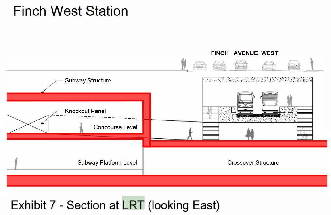

Besides the idea of a separate line from Scarborough to downtown, the other option for SSE is the station at Lawrence.
I saw this image from the FWLRT thread that reminded me of this.
Ignore the subway and look at the LRT portion to the right. This LRT station is directly under the Finch/Keele intersection. By scaling, the track are located about 6m below grade, with a passageway under it. This shows the solution to a possible McCowan/Lawrence station.
Locate the tracks about 6 to 8m below grade as they cross Lawrence. This allows the utilities from Lawrence to pass over the station box. A little north, the tracks would rise to being about 5m below grade, with traffic running directly on the subway structure. The "Mezzanine" for the station would be below the platform, much like the walkway. This "mezzanine" is only needed at the station, so why build the track an extra 5 or more meters in depth (and requiring the use of TBM) for its entire length, when you can instead build a shallow linear structure (using cut-and-cover).
Vibration, noise, surface disruption, pollution (from flange grinding), etc. Quite frankly, if they built a cut and cover subway line right next to my place, I wouldn't care about any of those things because the benefit of available transit greatly offsets the small noise and vibration. However, suburbanites tend to not be in support of such moves. People want it out of site and out of mind.
