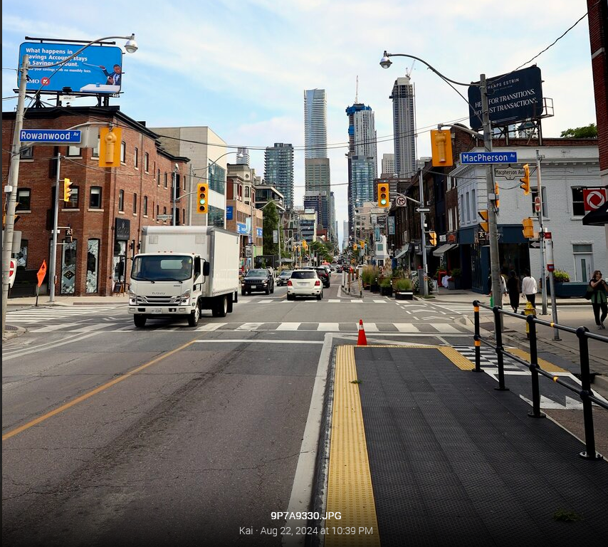

On the subject of the above work, I noted a photo by forum member @Kai over in the 11YV thread that is on point, so I will copy it over:
Of interest here is the new bus platform, with the cycle track between it and the sidewalk elevated by the intersection.
That is a very good design for deconflicting transit, cars, bicycles and riders. I guess we'd have to see how it stands up and how maintainable it is in all seasons.

Was referring to the bus transit stop island set away from the sidewalk, with the bike path going between.
