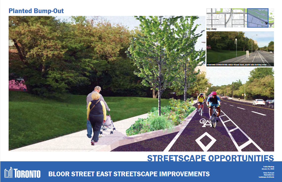

Streetscape proposal, west of Sherbourne, from 2016:
Note that bike lanes are now part of this proposal, but we're not then.
East of Sherbourne:
This image is unfortunately outdated. The city is working on a better "protected" design. Watermain construction was supposed to happen soon, but was delayed in order to improve the road design, and I assume the city will be making this a parking-protected cycle track.
