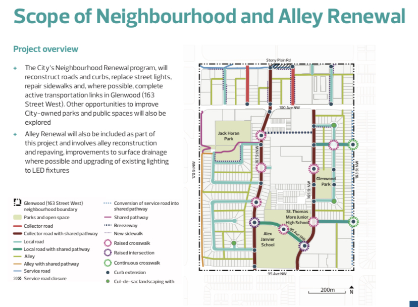

Glenwood renewal looks awesome.
I responded to the survey asking that they put the shared path back along 100 Ave (apparently it was in the draft design but removed from the final one). North South connections look great but east-west looks very disjointed.
I saw that. I wonder if it’s because of 95ave and 107ave and limited space for 100ave? Seems weird they’d remove without a great reason though. Let us know what they tell you if you get any response!
