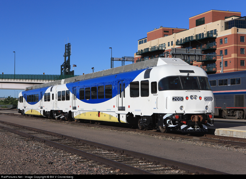

^ Yes my bad, almost forgot about these almost anachronistic clunkers from Colorado Railcar:

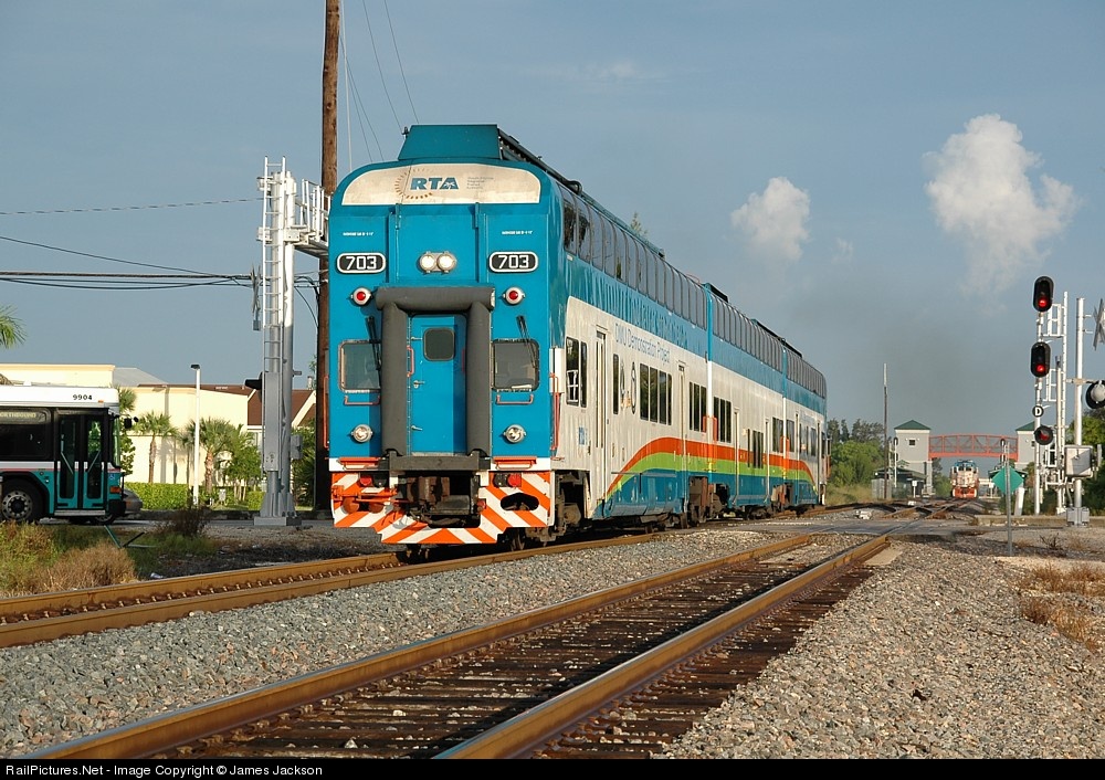

They have also made bilevel DMUs for Tri-Rail in Florida.

^ Yes my bad, almost forgot about these almost anachronistic clunkers from Colorado Railcar.
It doesn't look that bad in that photo. I wonder what their dispatch reliability has been and how their fuel consumption numbers look compared to the FRA non-compliant models.
I don't know the technical details of their current service, but I do know the opening of the line had to be delayed by half a year due to problems with the railcars.
Trimet had to pay Colorado Railcar's suppliers to ensure the DMU's would be built. Goes to show just how stringernt(and silly) FRA's regulations are.
