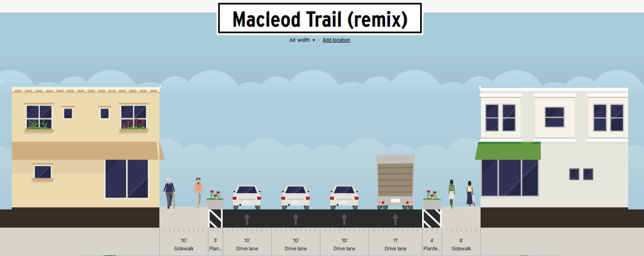

I strongly disagree that any change requires a negative effect on traffic. Here's the block Disraeli linked above as it is:
Here's an option:
Here's another one:
Here's one that doesn't require any concrete, although it would require signals changes for the cycle track:
This one doesn't even need signals; it could be done for the cost of paint, planters and parklets:
Here's a bare minimum:
Here's a link to try your own: https://streetmix.net/-/1071894
Note that the number of lanes is not affected in any of these.
