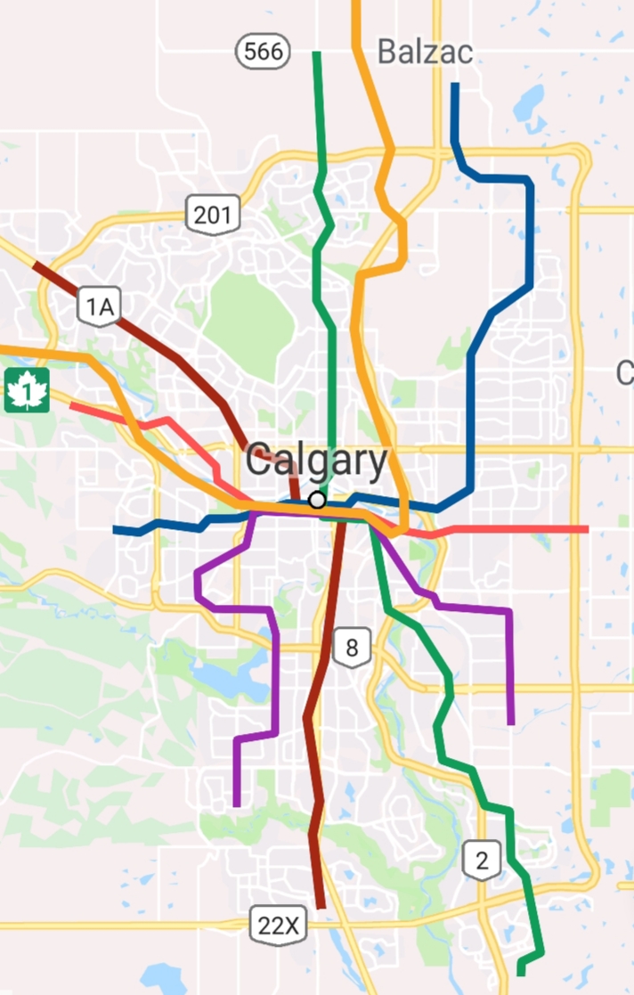

I know I'm rather late to the thread here, but I started doing this in Edmonton a few years ago and went for it again when I moved to Calgary this summer.
Red Line is as is, Green Line is as planned, Blue Line is as is with an extension to Cross Iron Mills.
Pink Line goes from East Hills to Olympic Park going down International Ave, through Downtown and passed Foothills & Alberta Children's Hospital.
Purple Line fills in the remaining corners of the city going from South of the Glenmore Reservoir to Heritage Park, Rocky View, Mount Royal and Downtown and then can be extended to the South East.
Gold Line is what links my former city to my current city. A high speed real line through the CalEd Corridor from Edmonton, to the Edmonton Airport, to Red Deer, to the Calgary Airport, to Downtown Calgary and then eventually out to Banff. Once in place additional lines can be added to the route stopping off a smaller centres along the way. This connects the corridor and gives tourist an easy way to fly into Calgary and get to Banff.
The High-speed rail line would also eliminate a need for a spur off of the Blue or Green Lines to the Airport as it would be a one stop link from Airport to the main station downtown.
I don't have any circle routes but I envision MAX routes connecting the outer reaches of each limb of the CTrain.
As all lines converge downtown I envision a large European style station South of the Calgary Tower. Where transfers can be made between all lines and the High Speed rail. Platforms to stories underground with retail space above them and connections to the Core Shopping Area and 7th Ave.

I like the pink line because both the international Ave and west 16 Ave corridors could increase density in big way with addition of train service.

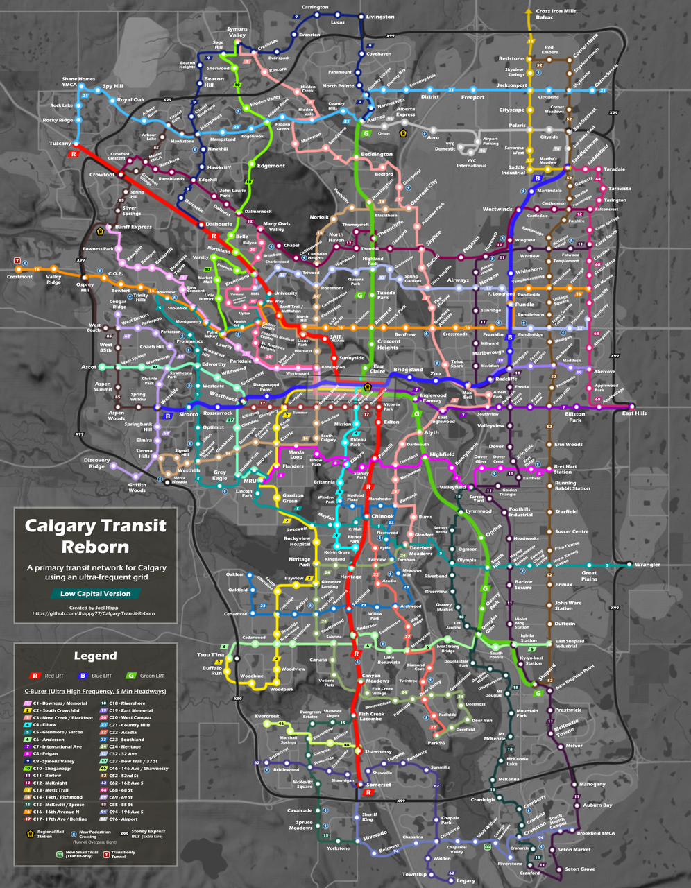

I've been working on this map for a while. It's a plan for a complete overhaul of CT, focused on a grid of fast, high frequency bus routes.
I also have a WIP 67-page long report on it here: https://docs.google.com/document/d/1SyxgfXDGrWfLdb-O2y3Dr1Dh2Pc6roHdbGsgMLN4z3Q/edit?usp=sharing
I want your feedback! How would you change the routes? Anything I missed?
Additionally, I'm going to make a version with no infills/extensions to the existing LRTs, no gondola or airport people mover, and no green line built past Shepard or Aurora to show how we could build this quickly and as cheaply as possible. If the Green and Blue lines didn't extend North, how would you redesign the bus routes in the far Northeast past Saddletowne and Aurora?
I'll be reposting this to reddit for a wider audience after a first round of revisions, so please don't repost this anywhere until then. Hope you enjoy! :)

Hey folks! Back with an update on the map I made earlier.
This map tries to be pretty cost conscious in terms of the infrastructure investments it would require (outside of the Green Line North expansion ofc).
I've put a lot of work into the accompanying report: https://docs.google.com/document/d/...c6roHdbGsgMLN4z3Q/edit#heading=h.2lcyws1c3vqu
Notably, I did a full operating analysis which estimates the cost of operating the entirely redesigned citywide bus network, including coverage routes (to the best of my ability). You can peep that analysis inside the document, and in this spreadsheet. Hope you enjoy this, and always happy for any feedback! :)

One thing that tempts me when thinking of projects like this is ‘quick win’ connectivity projects. Like where we could expropriate 3,4 houses to make a route much more direct by reconnecting a grid broken up by curvilinear neighbourhoods.
When trying to turn routes into lines and connect the grid, were there any places where it just gets messy and inefficient in your opinion?
The main culprits of the "connecting the grid" challenges are the river valleys, big hills, the railway, and Deerfoot - meaning any connection across them would probably cost a lot of money to complete.
I included one such connection in the map - a bridge across 194 Ave S along the C94 route. It seems simple enough and cheap enough to do, and IIRC based on development maps you probably don't even need to expropriate any properties to complete the link with a narrow bus-only road.
Here's a list of other grid connections I considered but ruled out:
  • Edworthy Street crossing the bow river to Point McKay would allow for a route (the C5 in my map) to beeline it to the UofC area instead of detouring around Sarcee & Trans Canada, saving around 4 minutes per trip compared to the current route
  • The gap between the terminus of 85th Street SW and Chiila Rise next to COP is already mostly complete - it's only 300m apart - but the grade would be around 20% so switchbacks would be necessary. Probably not worth it considering the west ring road is right next to it
  • You could theoretically build a connection between a route going down 24 St SW (our current Max Yellow, this map's C2) at Bebo Grove to Evergreen but it would cut through the heart of Fish Creek Park which would probably be very unpopular. I think a better alternative for a future Max Yellow / C2 extension is to have it go down Stoney to 37 St SW where they're building Alpine Park.
  • I think RouteAhead also tentatively calls for a transit crossing across the Bow on 210 Ave SW but the area does not seem to be ready for it yet
  • You could probably connect McKenzie Towne Boulevard / Mt McKenzie way with Deer Run and 153 Ave SE across the Bow.
  • You could connect 130 Ave SE with Canyon Meadows Drive SE - but the route would need to cross Poplar Island which is pretty questionable. That said, 130 Ave SE is supposed to be the site of a future neighborhood main street east of Stoney Trail and will lead to some 'strategic growth areas' for new neighborhood developments
Ultimately, most of those connections would be pretty costly relative to their benefit, at least at the moment. You probably wouldn't want any traffic beyond buses using them either.
On the flipside, there's a different kind of project that could give transit a lot of benefit for a relatively cheap cost. A lot of neighborhoods lack pedestrian permeability, which makes it incredibly difficult to provide adequate coverage without loopy windy suburban routes. We could fix this problem by building more alleywalks between houses, allowing for more direct pedestrian/bike routes between transit stops and houses. It probably wouldn't even be unpopular - you could expropriate the land around a fence on a property line, but then pay for new fences around the new alleywalk for both properties impacted. That would enable transit routes to take faster, more direct routes, like the ones I included in the map.
