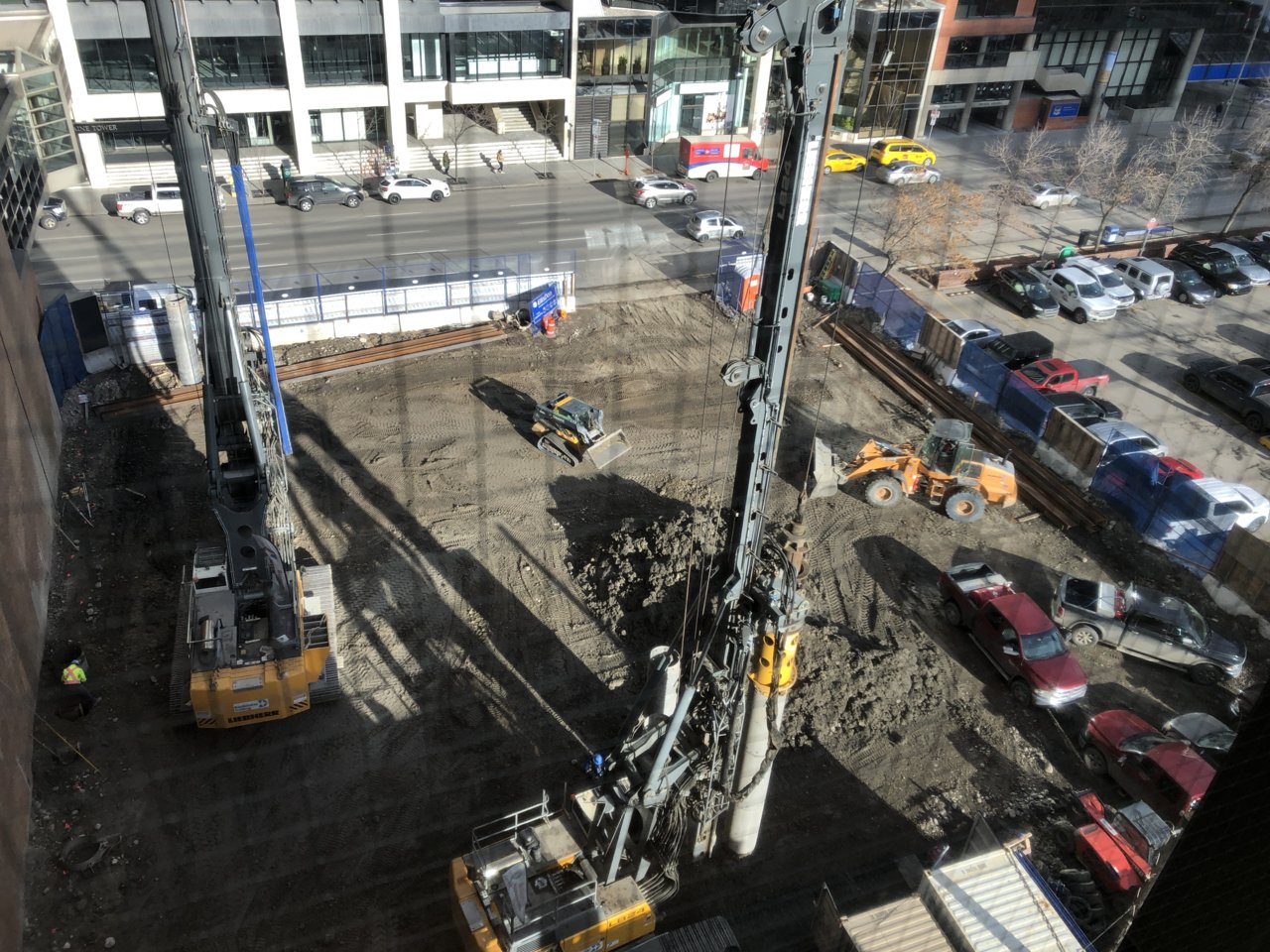

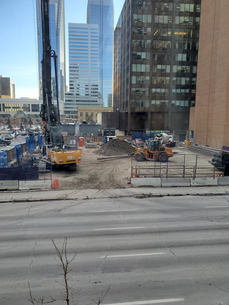

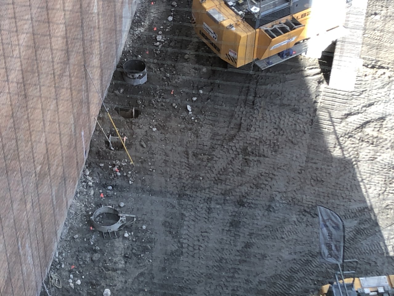

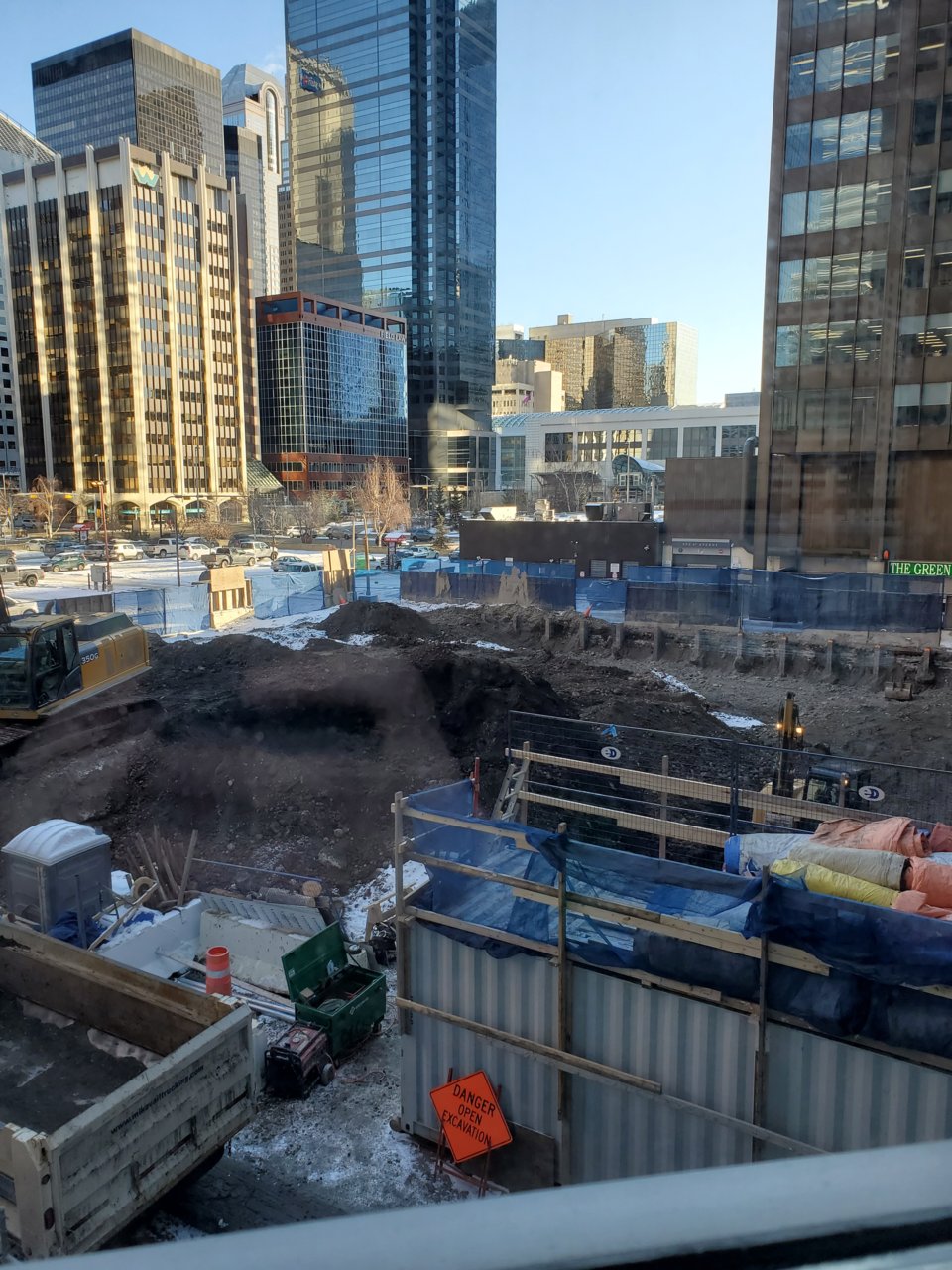

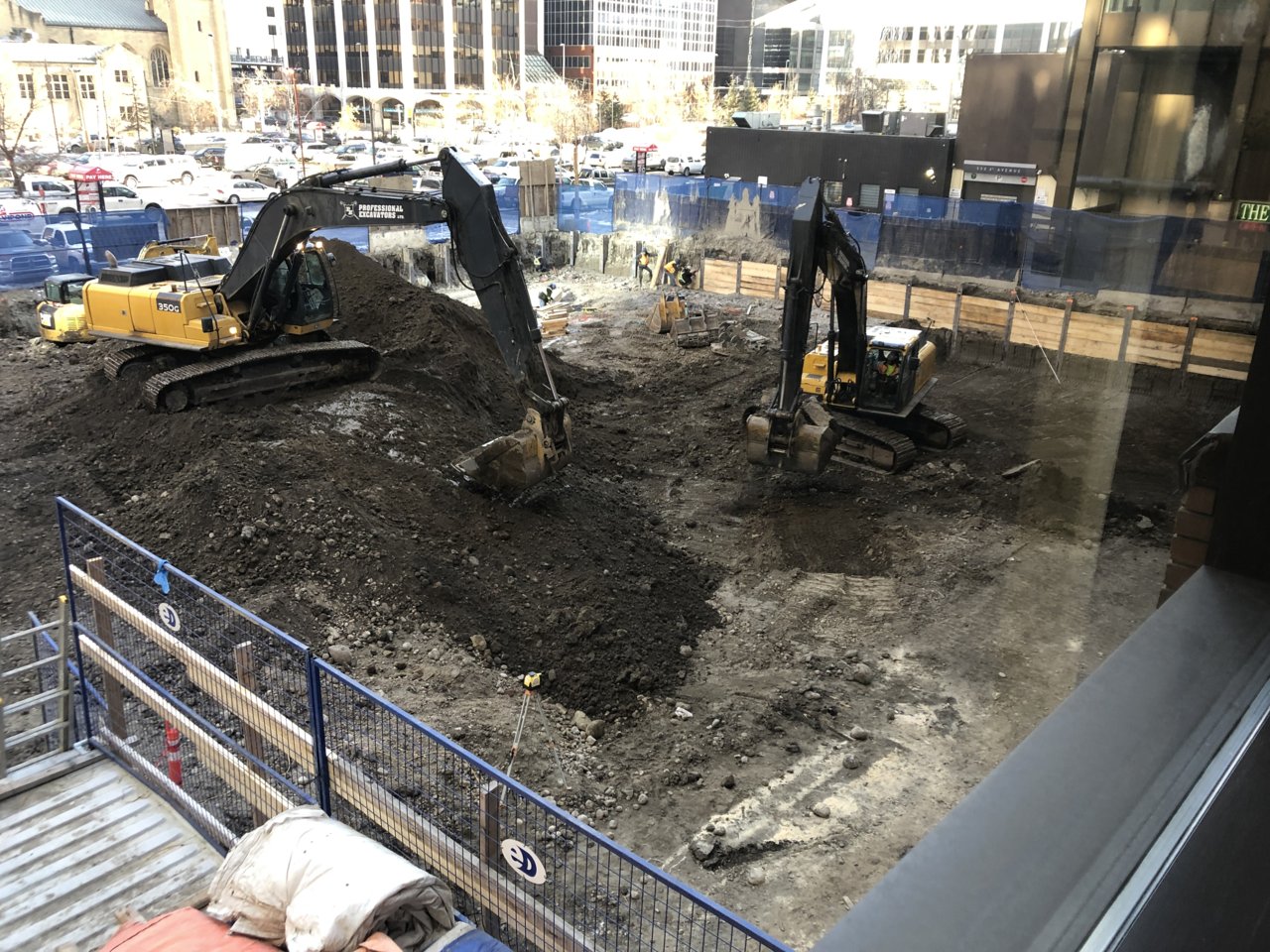

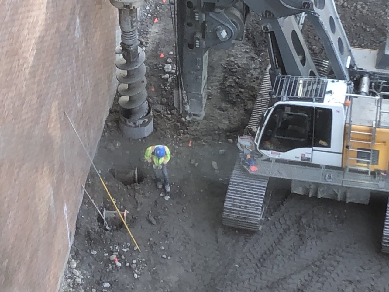

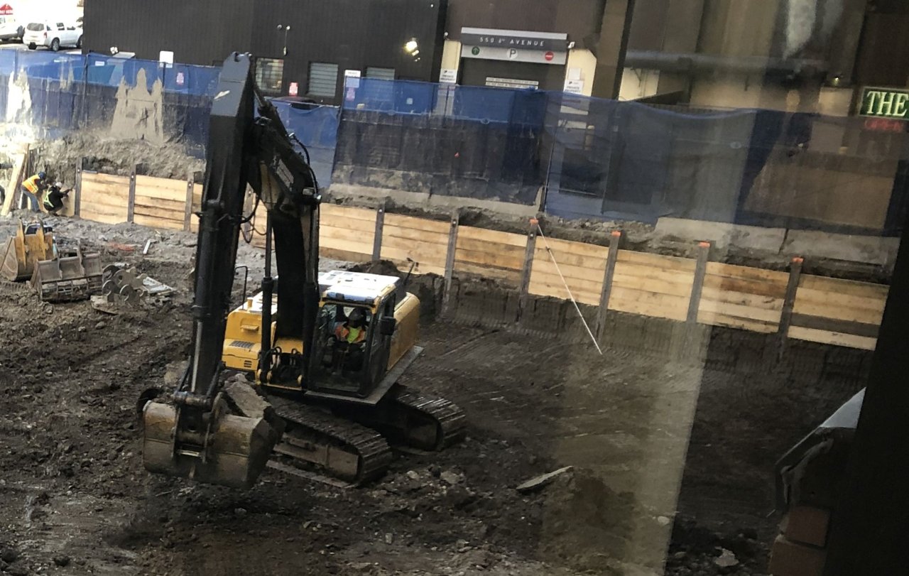

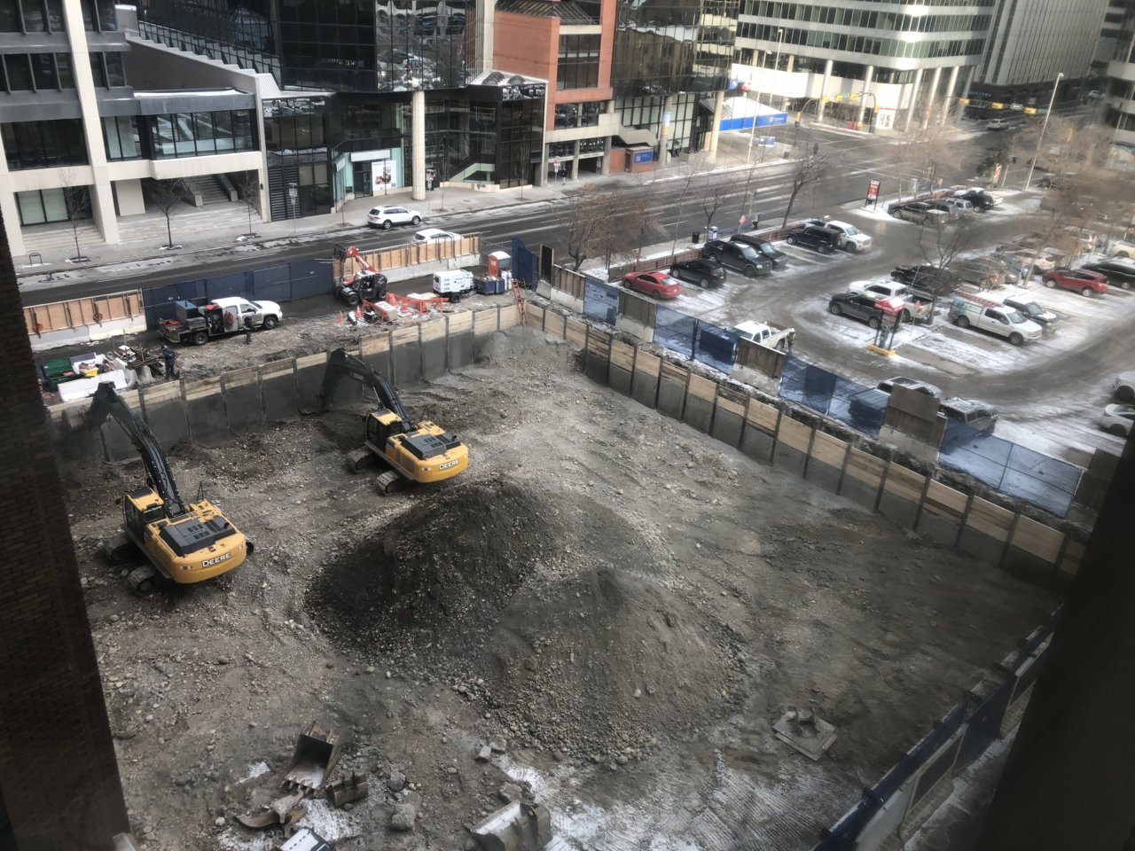

I wanted to comment on the pile install process after watching it happen for a couple of weeks. What they did in the end was drill holes roughly 2’ in diameter and roughly 4’ apart and filled them with concrete or slurry. They later did another round of holes right beside the first holes, and then later did a third round of holes next to the second holes…essentially having a string of holes touching each other and forming a concrete wall. The last holes the drilled had piles put into the holes, and then concrete slurry was poured in around the piles. A few days later backhoes started digging away the dirt, showing a wall of cylindrical concrete columns. The columns were shaved down to make a flat surface, using a backhoe with a flat blade.
Looking at past pictures of other sites, it looks like this is the method used at other sites. Just thought I’d pass this along in case anyone was wondering about it after the discussion earlier.
