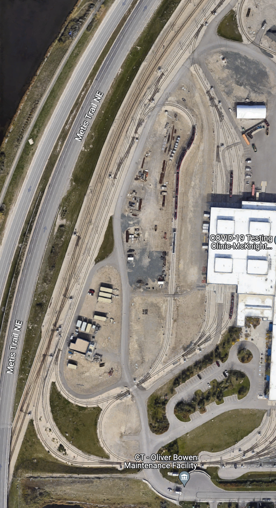

There is a LOT of extra room at Oliver Bowen where you could put storage tracks and expand the building, at least for a phased fleet expansion.

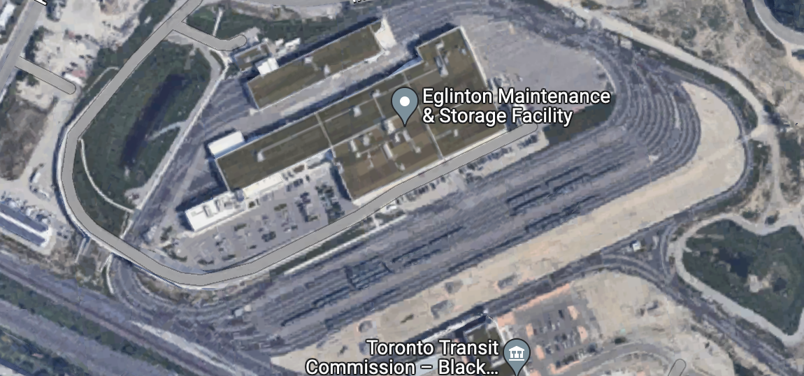

You can see how much more efficiently the land is used for the massive LRT line in West Toronto for the Eglinton Line, which is going to need well over 100 30 meter LRVs once it has been extended west.

Eglinton is not too dissimilar in size to OBMF, CT just has an entirely indoor storage barn and some other work is done at Anderson. The Shepard OMF is similarly huge anyways, not gonna save much by building a connection and expanding OBMF just to have an inferior product on Centre Street.

If you're running the same trains on the red, blue and green lines to save money by sharing garages, then you need some way that trains can drive between the lines to get to the garages. That's the connection that is required. It doesn't matter how much land CT does or doesn't have next to Metis Trail, they would either need to build a connection that connects red/blue above grade and green below grade track in the absolute middle of the downtown, or build some out-of-downtown connection, and at a minimum that **will** cost a billion dollars, whether there's one track or two.
