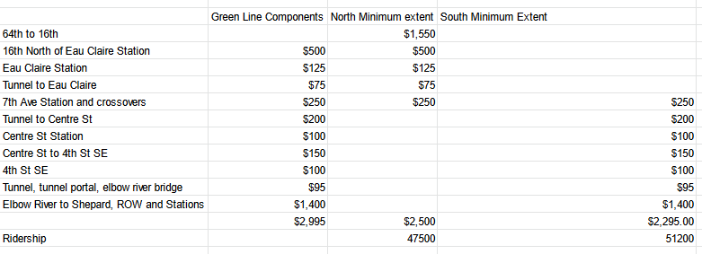

For phasing what we have for segments is something like this (removing OMC and LRVs from the Greenline, and offsetting greenline operating costs with bus service reductions to get a like for like comparison):
Now since both segments need the downtown segment to be successful, lets break up the Green Line Phase 1 and 2 to 7th Ave and North, and 7th Ave and South, to reflect the minimum possible project extents.
Lets work with this split (and remember that for the decision making process the numbers we can quibble with and still be fine; what matters more is we agree the proportion of each:
You can see even without the more advanced modeling of the incremental segments, that going south makes sense to do, even with all the other things being equal (like assuming an OMC costs the same to go north).
Now: what would I rather happen than what we're doing now?
Just build to McKenzie Towne and 64th nearly simultaneously.
There is no needs for these fights.
