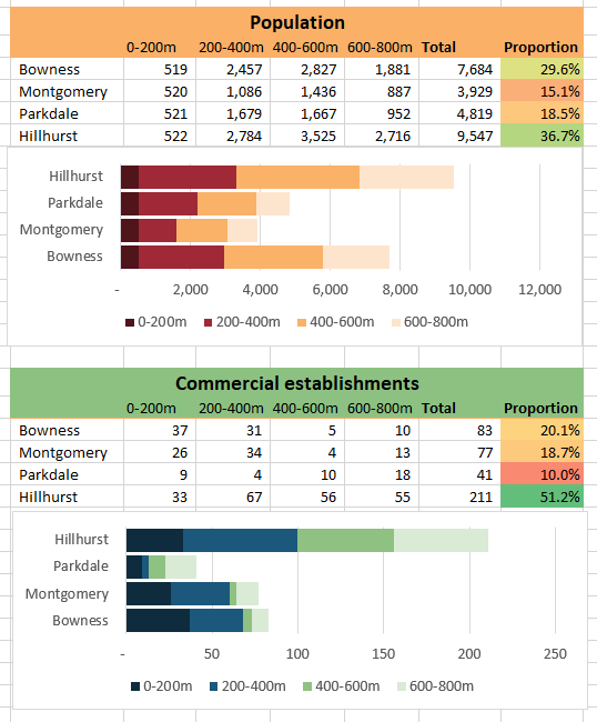

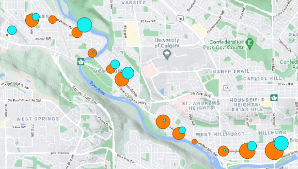

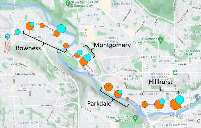

I don't have a strong opinion on what the 305 should do on the west end past 77th St; it currently goes to Bowfort Road and COP, maybe it should stop at Greenwich, maybe Trinity Hills, who knows -- there's so many little nodes scattered around there, none of them super vital. I don't know what sort of visitorship COP gets (in a normal tourist / sports season). Heck, this area is building out and maybe the best answer today is different in two years.
However, I think it'd be a mistake to take Crowchild when running as a MAX service. It does save time; Google says that it's 5 minutes from Parkdale/29th to 9th/11 St via Crowchild and 7 minutes via Kensington Road. The difference might be a little more when there's more traffic -- although the Crowchild route would skip what might be the only transit priority feature on the corridor, the bus advance light at Kensington/Parkdale by Pizza Bob's. So there is a benefit; it's 31 minutes from 77 St W to 2nd St downtown and it might save 2 or 3 minutes, maybe 10%.
But there's a cost for this benefit; the 305 would skip three stops, on Kensington Road at 14th St, at 19th St and then at Crowchild. And those are significant nodes.
Here's the entire corridor. The dots at each stop represent the activity; the orange ones are scaled to population within 400m walking distance (the largest is 1750 people at 14th St), and the blue ones are scaled to the number of businesses (the largest is 83 in Bowness). There's 14 stops on the route; the 14th St stop is #1 for people and #2 for businesses, the 19th St stop is #2 for people and #4 for businesses, the stop at Crowchild is #7 and #8, about the corridor average.
BRT should in theory -- if operated frequently, not six times a day like the 305 -- draw from further than 400m. But it's hard to evaluate individual stops at that level, since what's 800m from one stop might be right at the next one. So I looked at groups of stops in the four communities served; here's a map if needed:
The three stops in Hillhurst have about 1/3 of the population of the corridor and half of the businesses. Some of the businesses on the longer end is that Kensington Rd up to 10th St is within 800m of the 14th St stop, but I'd note that 1) this stop provides corridor residents access to Kensington, and 2) even without the further stops, there is more within 400m of the Hillhurst stops than there is within 800m of Montgomery or Bowness.
I think that serving all of the people with all of the travel time is better than serving 2/3 of the people with 10% less travel time.
Bonus fun fact: The reason the 305 doesn't follow the 1 all the way to 10th St is that the corner of Kensington Rd and 10th St is too tight for bendy buses.

Good reply. I had my opinion that the BRT should go down Bow, and turn onto Kensington RD/Parkdale BV via Crowchild for the time savings even at the expense of skipping the density of Hillhurt to avoid redundancy with the route 1. This is with an assumption that West Calgary residents would prefer directness to downtown rather than direct connection to the Kensington area. But the time savings could be very minimal, that still sticking through it's current route is an ideal option to provide rapid transit to a growing urban hot spot.
As for 10 ST corner. I believe (not 100%) the route 1 does have some articulated buses on it's route now. If it's indeed the case, then that corner may be not be the barrier it once was then. In that case, it makes the case for the BRT to go through the heart of Kensington on route to West Calgary a lot stronger in my mind. Residents in that part of town would be making Kensington their destination. So being dropped off right at the main corner of the street is very appealing. Same goes for those in that neighborhood that may appreciate having a stronger connection to Winsport and the development occurring around there.
