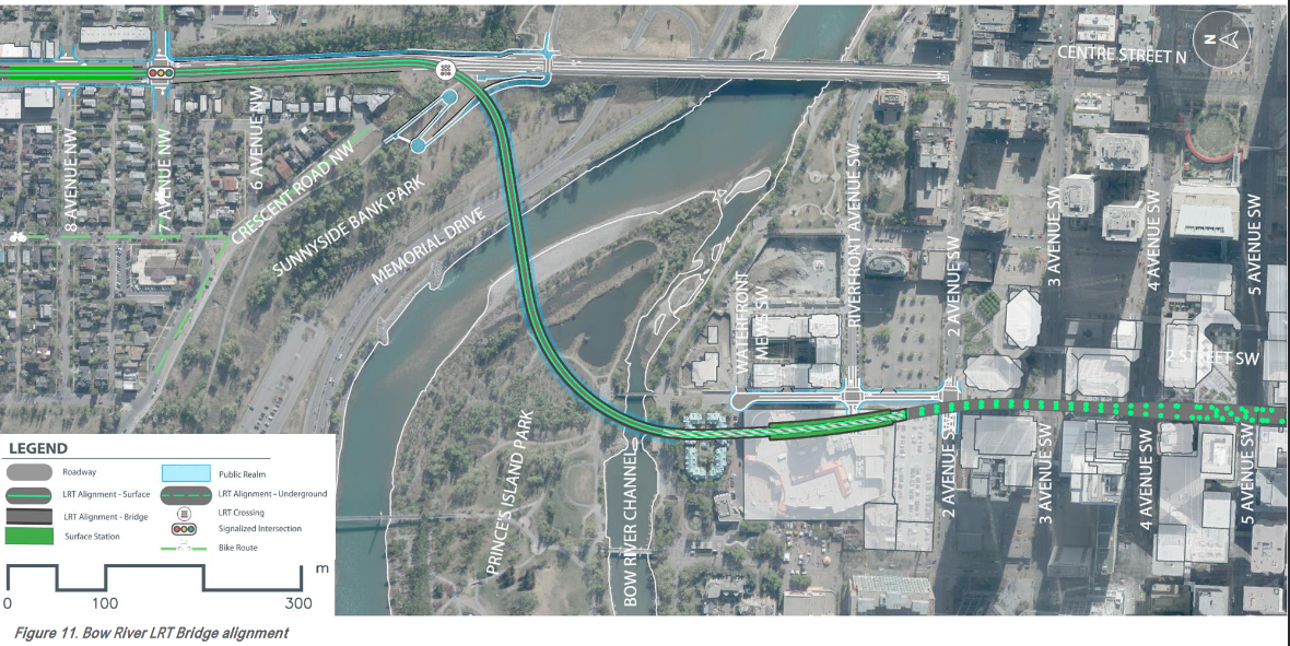

Proposed alternate alignment for the Greenline from Jim Gray and Barry Lester:
Their plan would totally detract from the interesting streetscape that has been created at the Public Library site. It would obliterate the lovely plaza at the southwest corner of the Library and a train clunking by on an elevated line through that area would be a horrible sight! The only benefit I can see from this cockamamie plan is that RiverRun condos would be saved as well as Prince’s Island Park.
I feel like RiverRun condos being taken out is probably the biggest plus of the bridging over the Bow option 🤷🏻‍♂️

The main issue is this, and that the deep bit of silt and clay is right at where the tunnel is supposed to run:
This is causing risk allocation issues, which in turn is causing a funding issue, because of the need for contingencies upon contingencies with the contracting strategy the city chose.

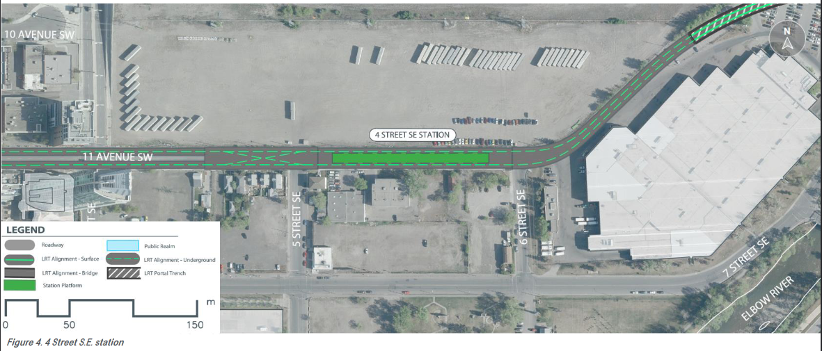

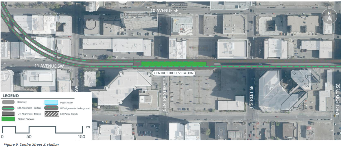

Tomorrow:
Where the BRT overlaps Green Line Stage 1 on Centre Street N south of 16 Avenue N there are significant challenges associated with accommodating all modes of movement efficiently. Centre Street N will be reduced to a single lane of vehicular traffic in each direction, will include a median running LRT and will have limited left turning opportunities. Consideration had been given to allowing the BRT to operate with the LRT in the median (See Figure 2-5). However, due to the limited distance that the BRT and LRT could operate in a shared right-of-way (ROW) (approximately 5 blocks), the potential operational challenges for both BRT and LRT operations and impacts to the urban realm required to facilitate bus access into the LRT ROW, the recommendation is that the BRT will operate in the general-purpose travel lanes. As a method to improve operations, no BRT stops have been proposed south of 16 Avenue N to minimize additional impacts to vehicular flows, which is the same as the existing BRT operations.
North of 16th Ave: During the initial evaluation of a potential median running option, it became apparent that this option would require a significant amount of ROW be acquired, particularly since left turn movements across the median would need to be made on a protected signal phase and the stations would need to be located in the medians. This along with the challenges that an implementation of a median BRT would have for the northerly extension of the LRT led us to not examine this option in a significant amount of detail.
