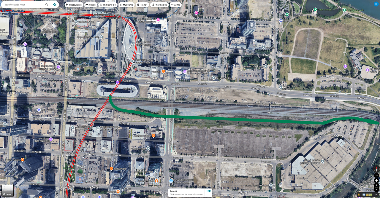

I've always thought there could be a hybrid solution:
- UG stations at Olympic Plaza and 2nd St SW
- Come to grade between 5th and 6th St Sw
- Surface station between 6th and 7th St SW ** (some parking access here that might be tough to work around without appropriation, so maybe everything has to shift 1 block west and you figure out how to deal with the 8 St intersection)
- Transition to elevated between 7th and 8th St SW
- Maybe an elevated station running N-S on 9 St at 6th Ave
It's about 600m station spacing and another 800m to Sunnyside, compared to today's ~350m spacing with 1300m between Sunnyside and the first DT station.
No +15 interactions to worry about while elevated, and I think it would be a lot easier to tie into the Bow River bridge from elevated than from UG (currently about 70m from north side of 4 Ave to the 'start' of the bridge)
I think it would be awfully hard to construct it without significantly impacting existing service.
Are they able to come from underground to at grade in such short distances? Especially with stations, it's going to be quite deep underground. I'm curious if CTransit has done studies on how much time underground vs existing actually saves. For movements within downtown, it's probably going to be almost zero because the time it takes to go into the underground stations probably makes up the difference. In Toronto, the PATH (+15 equivalent) is underground, so people are already at that level, whereas here, you are essentially going down 2/3 storeys to reach to station.
