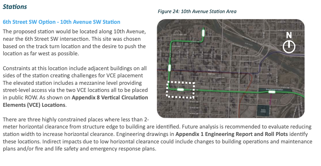

Can't say I like the station placement, if this is going to be elevated then they can scope the eau Claire station back in, four elevated stations would cost about the same as one underground.
As is, 2st should move a block south to integrate better with the subway that should get built at the same time. And 10av could move 2 blocks east for better spacing.

I'm really not sure why the stations need to be so contained in such a massive structure.
Between the multiple levels of station boxes, they seemed to take an underground station footprint and just bring it above ground.

Some notes about some things I found interesting.
The mandate from council is to use 2nd Street but not necessarily 10th Ave. I've personally tried to "square peg, round hole" a surface train on 11th and then begin the guideway portion much further west and turn it up 2nd Street but I do not want to block the much nicer properties on 11th. I was trying to use the fact that utilities had already been moved from 11th Ave but on the call, they said most of those utilities were moved to 12th Ave. 10th is the place to run the line. Just hope the guideway can be shifted to the northside of 10th Ave, at 9 metres wide (the width of guideway on the blue line) it doesn't have to cover the whole avenue.
Another thing was that staggered stations are being considered. I think a staggered station over 7th Ave would be thinner while still allowing for a central crossover area above 7th with a +15 level walkway below the guideway between Stephen Ave and 6th Ave. That would future proof the line to work with a Stephen Ave subway which is still something the City wants to do. I wish the 10th Ave station could be moved off 10th and on to the parking lot but I don't know if the City wants to buy that whole property. Could also be awkward to turn onto the property from 10th Ave.
I'd rather leave that lot for future development right next to the station. Granted I've been an L booster since the start (despite my misgivings for the incompetence and recklessness of our provincial government).
I do think a covered street would make for an interesting feel to the public realm, likelier to be "Calgary's grungy living room on 10 Ave" over "Calgary's oppressive eye sore on 10 Ave".

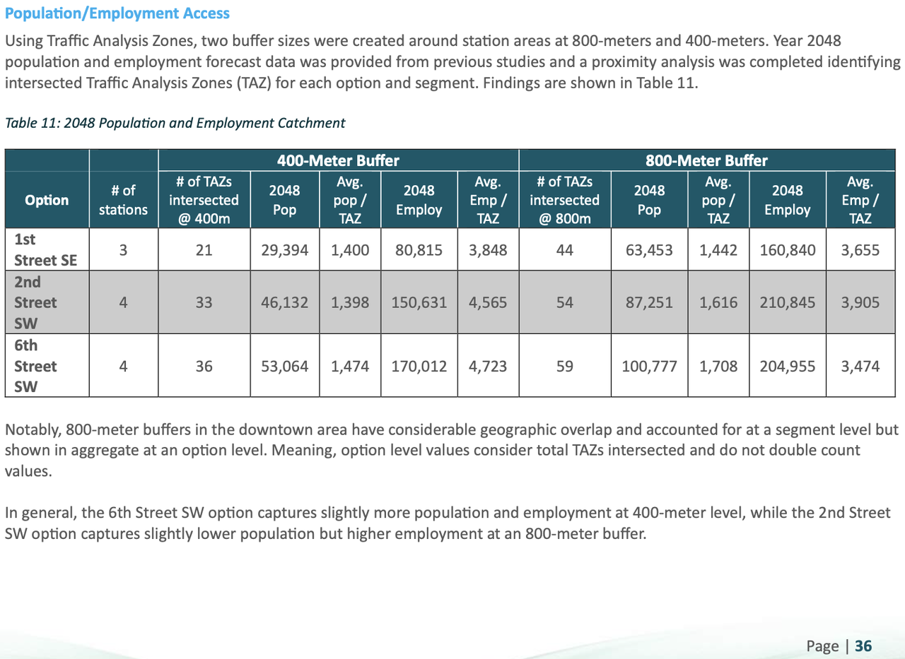

But +1 for the suggestions to optimize the space there and for 7 Ave Station. That Downtown Station has some serious opportunity waiting for it if they can stick the landing. Future subway connection, existing CORE mall & Stephen Ave connection, potential 250m+ on the NW corner of that intersection (foundation is poured for it).
Ridership estimates already put that station close to Waterfront in Vancouver, and that's without doubling it in the future with a north line.
