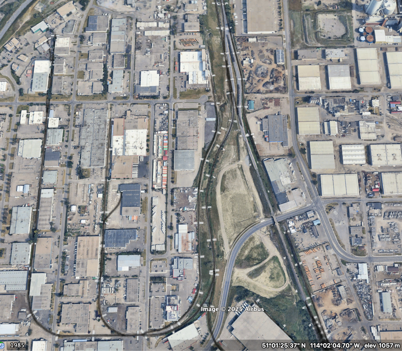

I never noticed the conflicts with some spur lines here - it looks like at least one of them is still in service (near the top centre of this photo you can see 4 train cars on the east side of the building that's just south of the bunch of school buses parked - it's called Hood Plastics on google maps). Does it stay elevated from Blackfoot Tr until just before Highfield Station?
