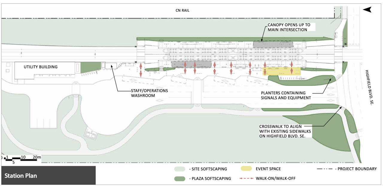

Highfield Blvd (aka 42 Ave) is definitely a level crossing.
It won't touch Highfield Cres (aka 46 ave aka 15 St) - I thought that road might be higher on the bluff but didn't check until now.
29 St SE is the other question, but I'm 99% sure it's a level crossing. There is currently a transit only road 200m to the NW and it looks like that will remain, so level crossings on each side of Douglas Glen Station:
So I think it's essentially 5 crossing spots: Highfielfd Blvd, 86av 107av, 29 St (x2) and 40st. It wouldn't take too much to remedy that, but you'd have to commit to going fully elevated the rest of the way south as the route doesn't go more than a couple hundred meters without crossing a road.
