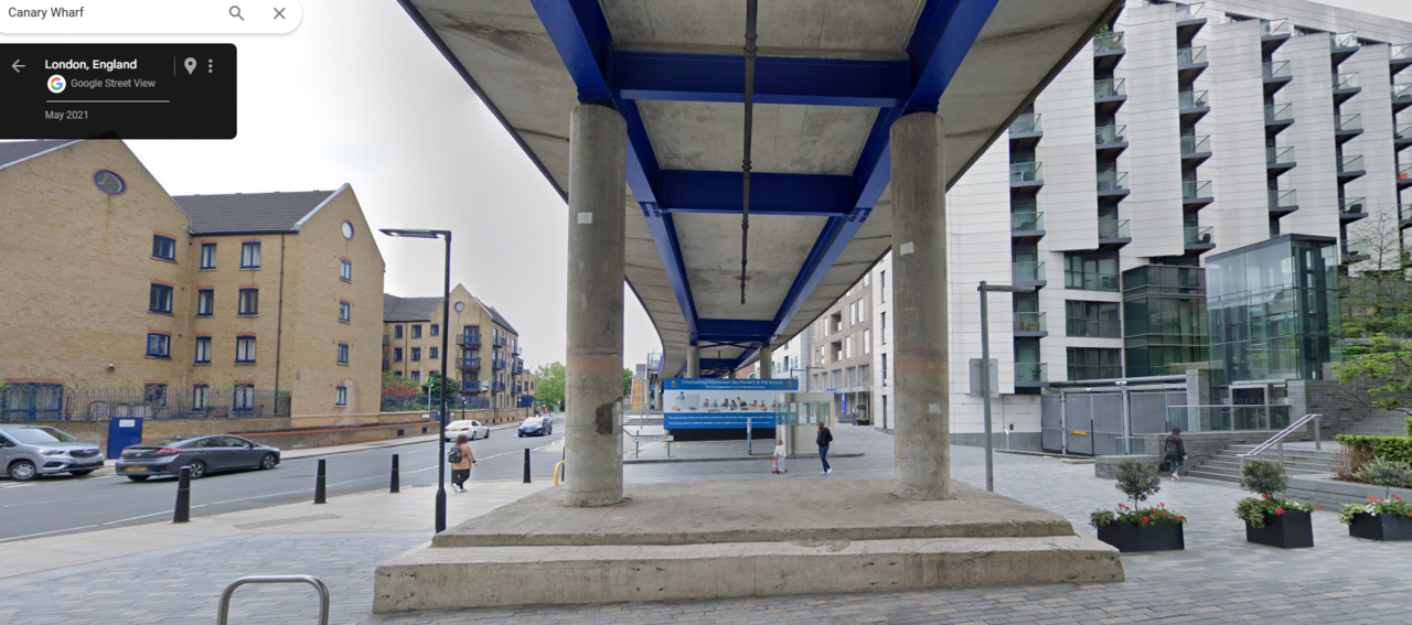

The DLR in London has significant elevated sections but again, they are built to work with the enviroment and streetscapes that they are placed in.
View attachment 621209View attachment 621210View attachment 621211
