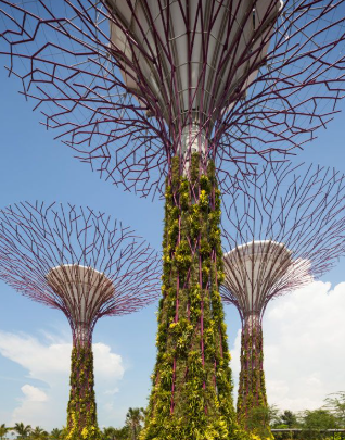

I think you could do a Platform/Scotia Fireplace style metal fin on the concrete column, add some hardy vine and lighting and you could get close to a affordable version of it. Would definitely make for a more appealing ground-level feel.

I went to AI... Stretch your imagination and you can see what I was thinking.
The Sunalta LRT station is 85 feet wide at the access point; it's only 75 feet across 10th St from building to building. I think that fitting 85 feet of station into a 75 foot wide space probably requires more than handwaving, and a "surely it can't be that bad".
